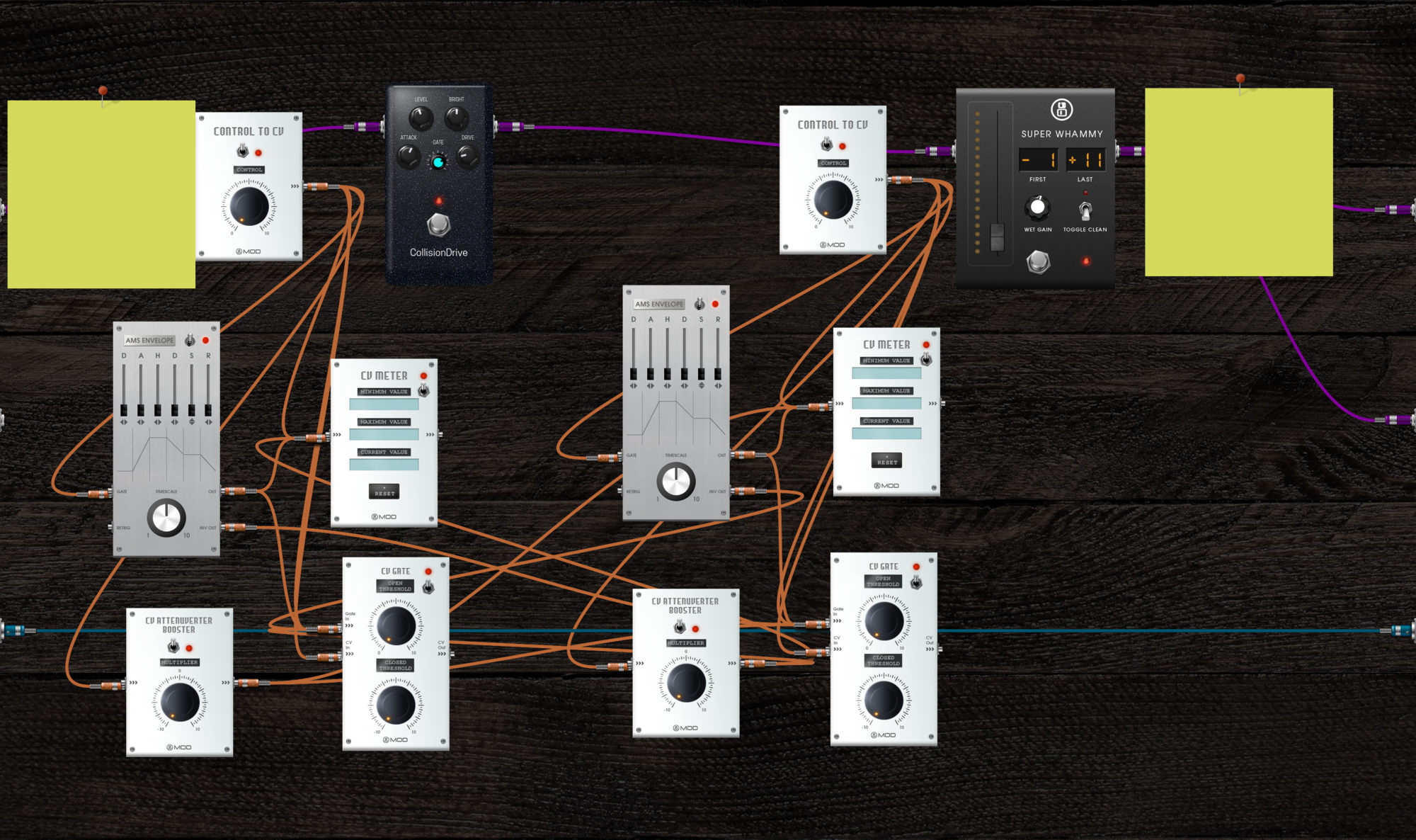

At least I can show what I want. Now, there has to be a much simpler way to do the same thing.
It seems to be scalable, I have done one with 3 effects (I added the SVT with the exact same 4 cv plugins (control to cv, envelope, attenuverter and gate).
+1 here !
I’ve done a similar request here 7 months ago :
A slightly simpler version (I managed to take out the attenuverter)
So here it is
Each effect is driven by a gate. The gate can only be opened by the user flicking the cv to control button. Its cv signal sent to the gate is boosted by an envelope, making it go over the open threshold.
In parallel, that same envelope is sending an inverted signal to the other gates, shutting them off.
Each gate has a cv meter measuring what is coming to it… very useful to tweak the envelopes.

I admire your perseverance. But as I said before, there is an unsolvable issue at the footswitch and feedback level.
Let’s be more tangible and see what happens in your pedalboard. You used 2 Control to CV to turn on/off the distorsion and whammy plugins. When you turn on the 1st one, it turns on the disto and turns off the whammy but it doesn’t turn off the 2nd Control to CV. So the latter’s state becomes unrelated to the one of its associated plugin and you have to turn it off and on again to have an effect.
I suppose that the 2 Control to CV should be assigned to footswitches to make the peadalboard useful. And on the Dwarf’s screen you will have that situation where the 2 footswitches are “on” although only one effect is enabled. This means that the feedback will confuse you and you will sometimes have to make a double tap to enable an effect.
