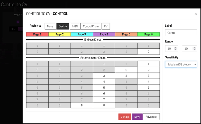

At the moment you can assign all buttons of the duox with the Control to CV plugin. Would it be possible to assign the buttons as well?
I think you have a typo, that sentence makes no sense.
“we can assign all buttons, can we assign buttons too?”
Right, that was a bug on my part.
Correction of my sentence:
At the moment you can assign all knobs of the duox with the Control to CV plugin. Would it be possible to assign the buttons as well?
Everything is possible if you go hard enough.
If you have the “control to cv” at value 10, and then something after that either lets the signal pass through or cuts it to zero, you can map that 2nd plugin on/off to a button
I can’t assign the button to it, I can only do that with the knobs.
cant you just map the “control to cv” on/off switch to a button?
if the plugin is off, the cv output port should go to zero.
Yes that does exactly what I want. Thank you very much!
I would not have thought of that, but in retrospect it is logical.
