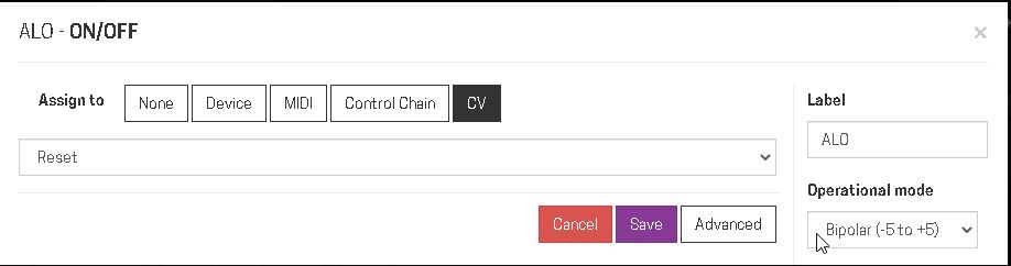

I’d like to do a mute in the tiny volume control (turn ON a mute) but at the same time turn OFF the ALO looper.

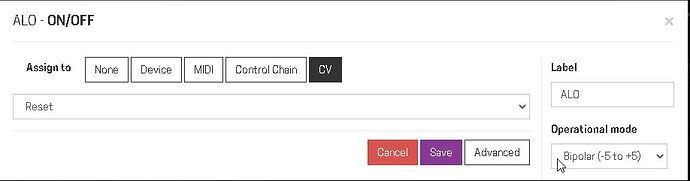

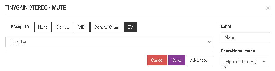

Currently the setup is as follows
With the looper setup as follows:

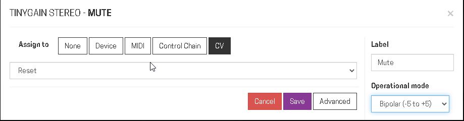

And the tinygain mute, like this
However, what happens is that currently - this turns ON the looper but mutes (turns ON the mute) of the tiny volume (and vice versa). But what I would like is that it turns ON the looper and OFF the mute, and conversely, OFF the looper and ON the mute.

You can place a CV plugin after the “control to cv” output that inverts the signal (or in technical terms, multiplies all values by -1)
Thanks for the explanation - now solved!

Just in case anyone else needs to do this
Here are the two CV plugins
with the CV ports “Reset” and “Unmuter” created

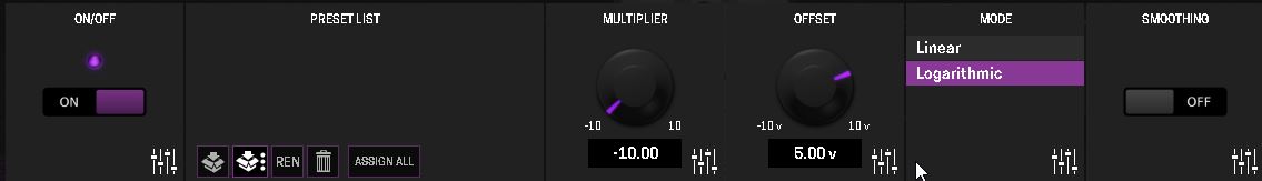

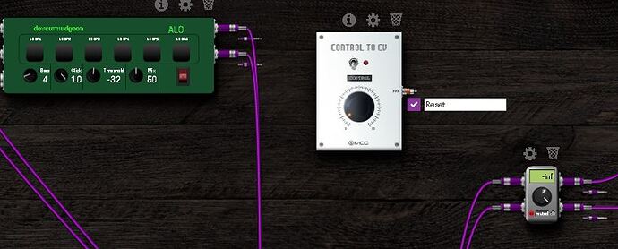

Here’s the Control to CV
Here’s the “Attenuverter” which inverts the polarity of the control voltage

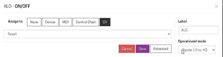

Here is how the alo looper is set up to receive the uninverted cv

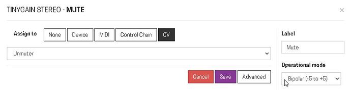

Here is how the tinygain is set up to receive the inverted cv
