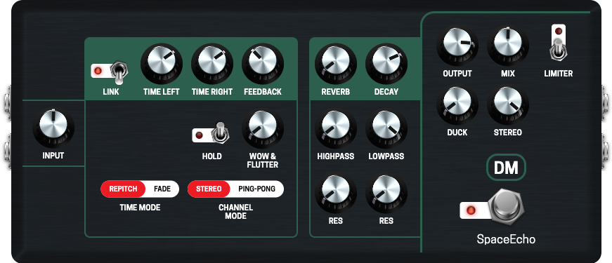

New plugin: dm-SpaceEcho
This plugin is delay and reverb combined. Crank the feedback to get that nice oscillating saturated Space Echo sound (Karma Police ending anyone?). Dial in the wow & flutter to go from a tight digital delay to tape-like modulation. Go for ping-pong or stereo delay. Control the stereo width. Tweak the filter to create a dub delay etc. etc. …
There’s plenty of controls and plenty to explore here.
Be aware that when you set feedback higher than 100% you get higher output gain. The output gain is controlled to a large extent. But if you encounter clipping turn down the output level. Or if that’s not satisfactory engage the limiter.
This plugin is not yet in the BETA store. If you want to check it out, you can find a build here: Releases · davemollen/dm-SpaceEcho · GitHub
