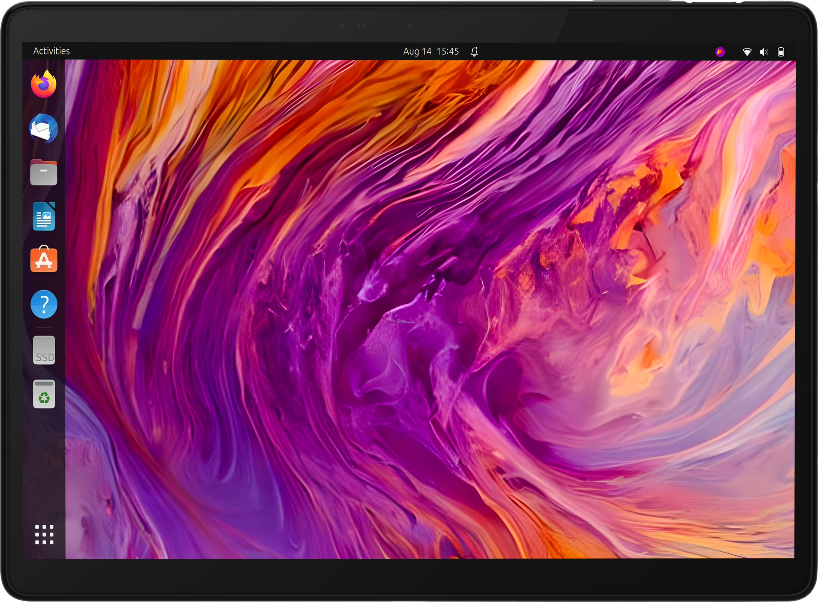

Here are another two tablets (with keyboard + stylus).
