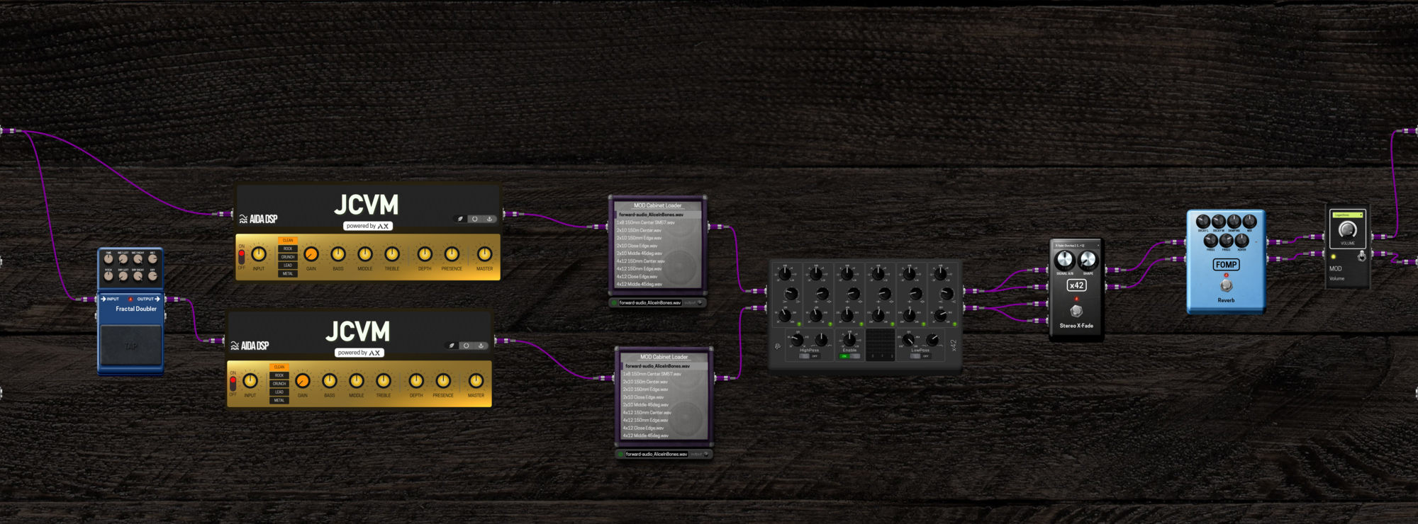

And to kick it off, here’s my Chug Station.
I really love the JCVM and in this board I am mixing two instances of it, one with a mid boost and another with a mid reduction. Each amp goes to a different cabinet. Both mid frequencies adjustable. Also is the amp mix.
A switchable fractal doubler to give a bit more of space between the two amps.
A reverb with the lowest possible time and size, high damping, and a gain on the low end - which I call the “oompf adjustment”.
Last, but surely not least, a “bee kill” switch and adjustment to take care of the amount of buzzing in the back.
Hope you enjoy :metal:

Please elaborate on this
I did not want to put it in such words, but yes. It is :slight_smile:
Take your time. No worries.
The buzzing we hear in the back when we crank up the gain. When one saturates a signal, harmonics appear on the higher end. It sounds like a “buzzing bee”. I add a low pass with a bit of an overshoot to avoid this buzzing. In this board you can enable the feature or not and you can also set the frequency.

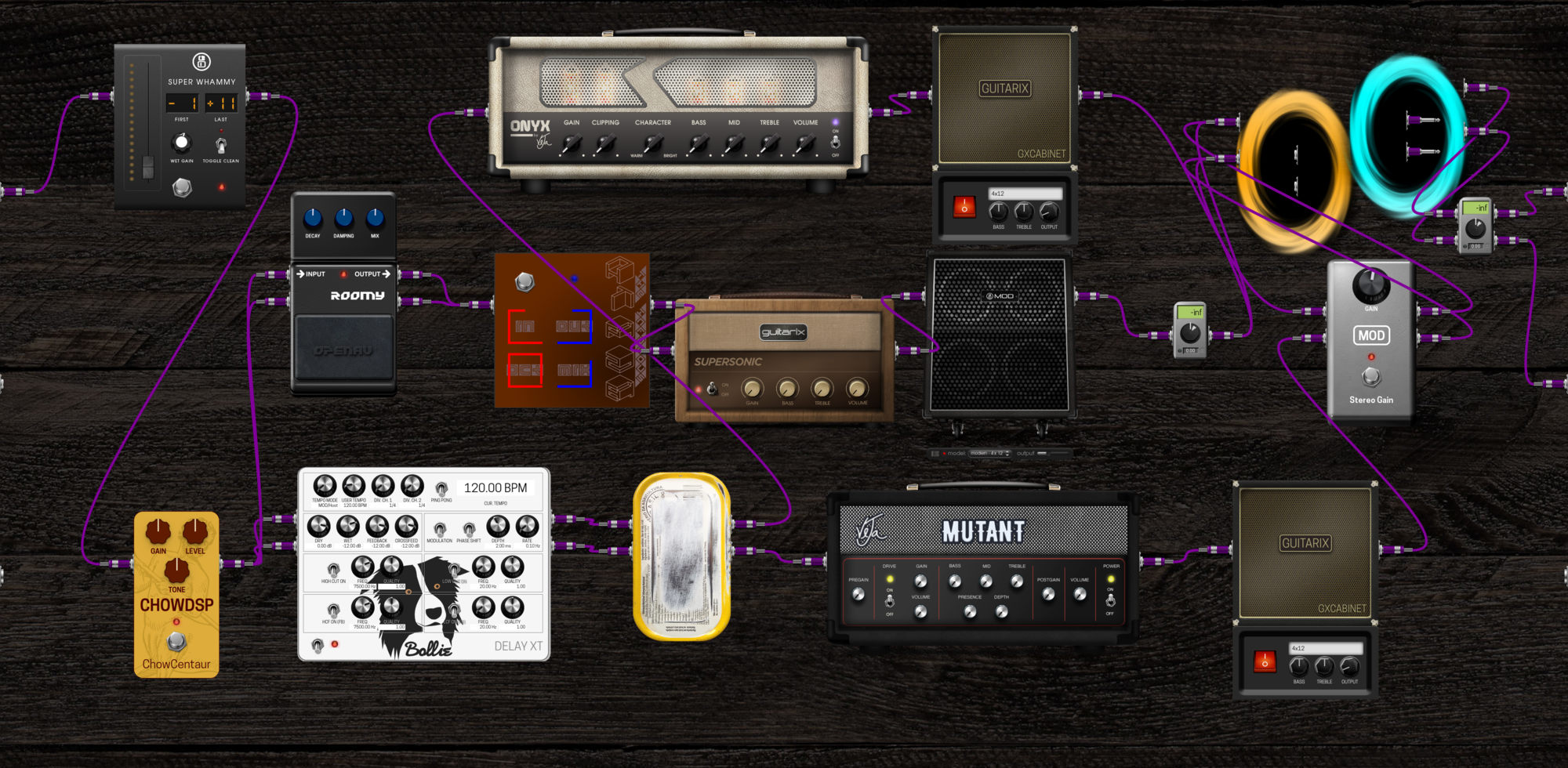

I might have over-done it a bit on this one :smiling_imp:
Aaaaall the gaiiiin!!!11 :wink:

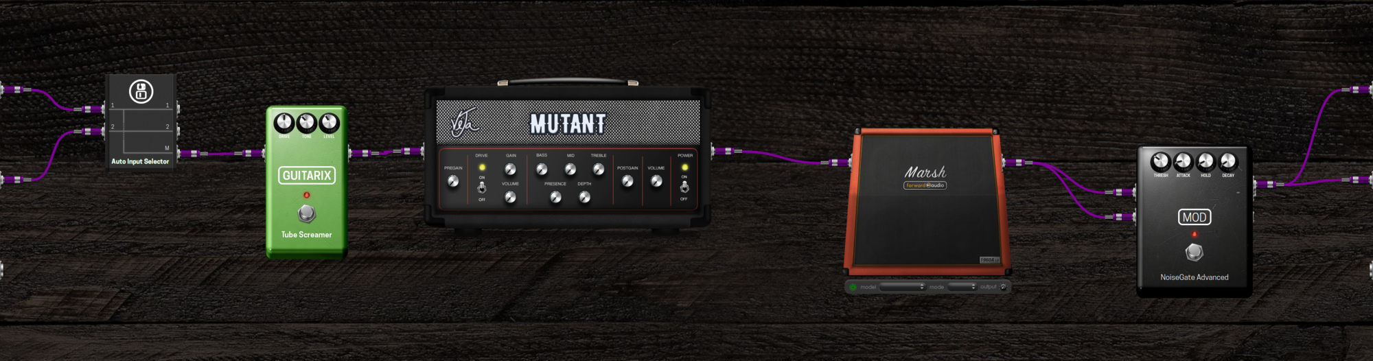

I haven’t purchased the Marshall cabs, so I’m getting the understandable audio drop outs. But from what I’ve heard from this board, it sounds perfect for a playthrough of King Gizzard and the Lizard Wizard’s latest album. Absolutely thrashy.

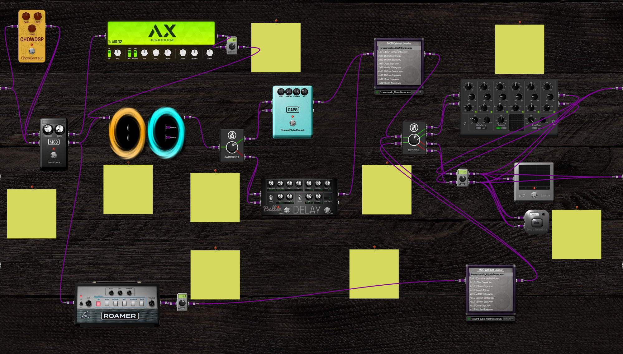

I’ve been testing and building a CHUGBOARD.
I assumed that the AIDA-X models and IR’s used in snapshots will be included when a user downloads this bord, that is correct?
I’m the rhythm guitarist/singer for a Thrash/heavy Metal band and this board is my “palette” to find a good match with our lead guitarist’s sound.
The guitar used for testing and creating snapshots was an Explorer copy with bridge pickup selected, given that the neck also sounded good.
  • It contains a BETA plugin: the Portal: It IS necessary to keep the processor load from maxing out.
  • The board also several post its with explanations
  • There are 4 high gain AIDA-X models I captured myself, all in the “5150 family” or related
  • I think I picked out about 10 to 12 different cabs and matched them with amp models
  • You can blend in a bass amp for extra low end oomph
  • There is a dry/delay switch. The dry path has a short reverb in it but is default off.
  • You can include an EQ or bypass it with another switch
  • There is a recorder to record your jams
  • gain control after the AIDA-X and in the end to manage levels
  • easiest test is done via the WEB-UI although some basic controls are assigned to hardware buttons…but I havent assigned the models/cabs to a rotary yet (sorry :/)
