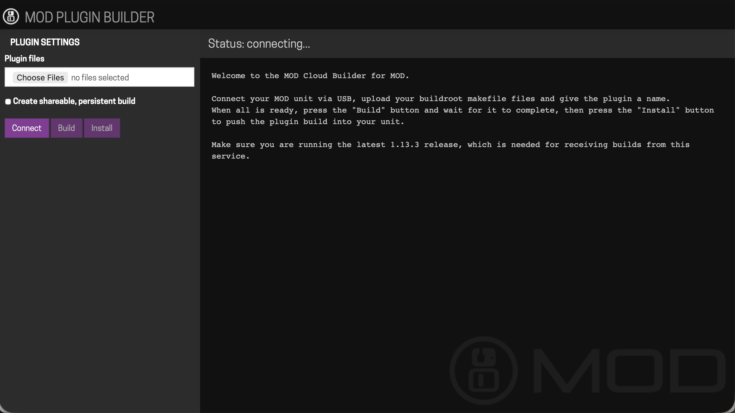

  2. Go to our Cloud Builder
    and upload the .mk file from the previous step. You’ll need a MOD
    unit connected over USB to proceed.
  3. Tell the Builder to Build, then Install the plugin.

ok slight problem, Ive been busy building a few plugins whilst Ive been away from my dwarf. So this morning super excited to see my creations and I can’t connect to the cloud builder no matter what I do. The dwarf is seen by the editor on 192.168.51.1 as normal , the cloud builder will see my mk files but wont connect to dwarf. Done the usual different cables and even asked my new best buddy Claude who advised I change the insecure flag in chrome but to no avail.
Tried chome and edge so far. Im on windows 10
My dwarf is 1.13.5.3315 firmware
Any thoughts?

you can open the Web UI and it does authenticate with the MOD Cloud?
I am using Safari and it works fine.
Here are your two builds:
Reverse-Reverb: MOD Cloud Builder
Reverse-Reverb1: MOD Cloud Builder
sorry Gianfranco , I’m not sure what you mean? I have update all my plugins without a problem and it says my firmware is upto date if thats what you mean. I am able to create pedalboards as normal that transfer as expected to the dwarf instantaneously too. I tried the links that you gave me for my test plugins but still not connecting to the builder.
Don’t think I can use Safari on windows can I?
mmm… seems all ok on the cloud side then.
have you tried another browser? private window? clean cache?
Hi. I had similar problems with Windows browsers and solved them using Firefox.
Cheers guys will try that later and report back. Thanks for you help so far, appreciate it
Up and running on Firefox!!!
Also I ticked the shareable persistent build and it seems to have created for anagram as well as duo and duox. Does this work on anagram too then?
No. It gets built just because Anagram is listed in the list of targets of mod-plugin-builder, but it will not actually be able to install on the device.
I’ll see how to skip it.
