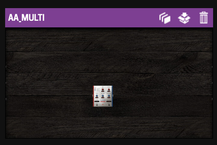

  • Fixed bug with deleting midi mappings which was leading to duplicates being saved to the pedalboard.
  • All pedalboards now shown in single and multi view, icon added to show if multi.
  • If user loads a single or multi pedalboard in another mode then (Single) or (Multi) is added to the name to avoid overwriting the original.
The multi icon is that one to the left of the download button:

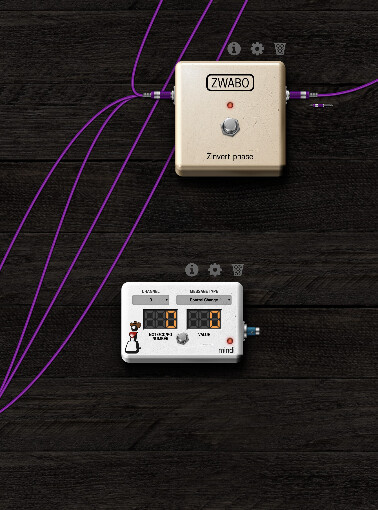

The problem comes with a Infamous midi (the one one the bottom right, that is there to send PC messages to the MC6 controller), when I remove it I can save.

mmm, the one just under the invert_phase?
I have done what you said with that one and it saved.
But I have not got all the plugins installed so it might be something there, I will install those plugins so we have an even playing field…
Yes !
I don’t know where to look in the pedalboard files, but I suspect that the mapping of the button value stays somewhere in the file…
Do you know where I can look ?
I can’t replicate it here and I can’t see that the button is mapped to anything!
The best place to check is in the bindings screen.

I have the mapping now but the mindi is not connected to an output, is that what you would expect?
Also still seems to save :slight_smile:
Let me check I am doing this correctly.
I drag a new mindi on top of that one.
I set it to program change and 9
I save
Also if you are happy to ssh to the dwarf and run a command in the terminal we can see what is going on when yours fails to save as I cannot replicate it?
The midi output of th mindi goes to the midi output that send to my morningstar controller.
Yes ! That’s it ! I still can do this and have the Bug!

Nice thanks.
KeyError: ':presets'
Something to do with presets, I’ll look into it tomorrow. I might need to get you a version with more logging to track it down…
mmm…
I use a preset tu set the mindi to the program change 9 on channel 0…
I’ve tried to save without using preset, and it works…
It may be a Starless problem or even a mod one ?
Nope, it will be something to do with me :slight_smile:
If you remove the presets and then add them again does that save ok?
It’s weird it is working here, you can see they exist:
[00:31:19.134186] 37     DEBUG  : host:get_multi_addressing_for_symbol_and_type():9134 MA get_multi_addressing_for_symbol_and_type /graph/mindi_1, :presets, 3
[00:31:19.137770] 3      DEBUG  : host:get_multi_addressing_for_symbol_and_type():9134 MA get_multi_addressing_for_symbol_and_type /graph/mindi_1, :presets, 1
[00:31:19.139286] 1      DEBUG  : host:get_multi_addressing_for_symbol_and_type():9134 MA get_multi_addressing_for_symbol_and_type /graph/mindi_1, :presets, 2
And then it fails to find them elsewhere as the save uses different data, something is getting out of sync somehow!
I have to ask for the preset before I can remove it, then remove it, then change the potentiometer anywhere → it goes to the Bug!
