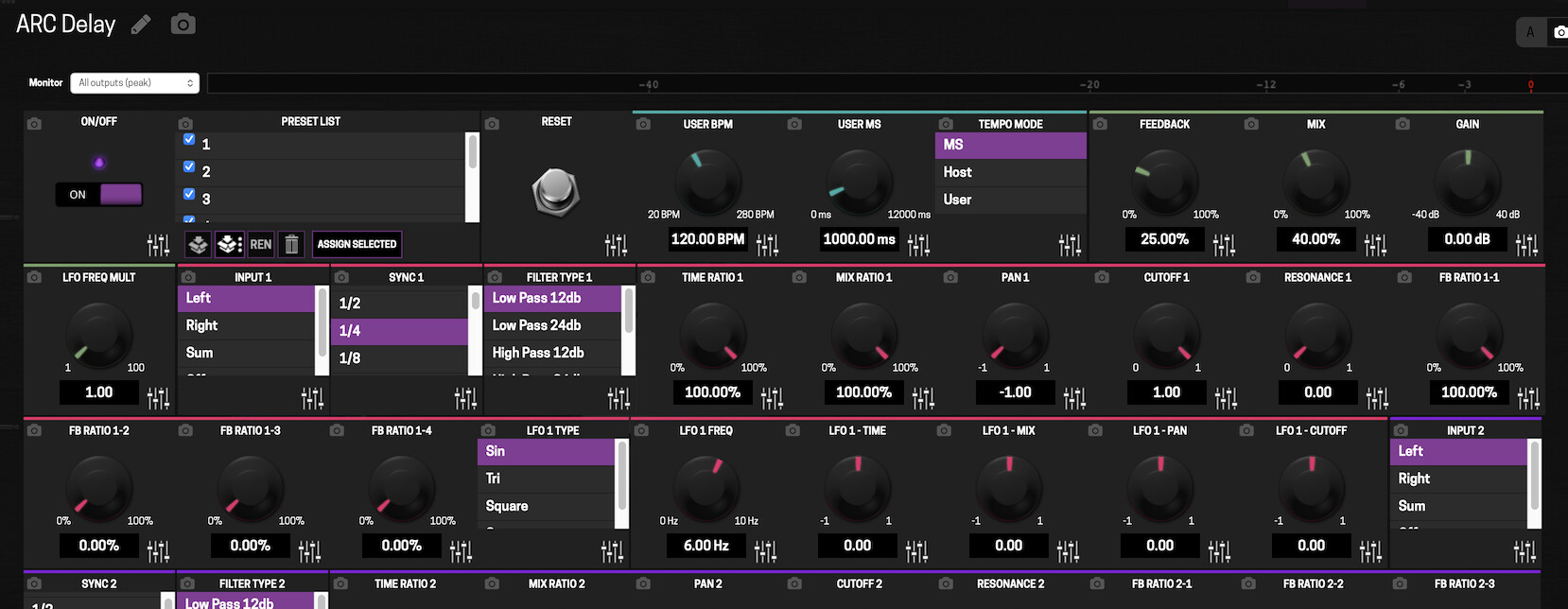

Been looking at signifying what is mapped, I thought of colouring the sliders:
Or still keep the background?
Yes ! Worked all the morning on the webUI, and it’s perfect ! Thanks !
Keeping the background is a bit ugly, but since there is not enough contrats in the whole webUI maybe it’s the better. But I prefer personally your 1st proposition !

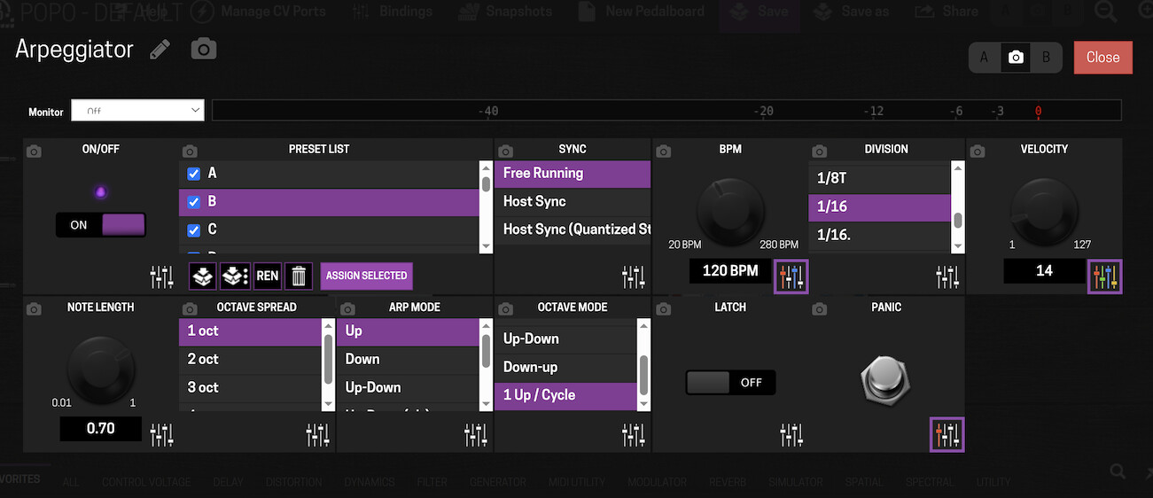

Maybe something like this would be the best of the 2 worlds ?
Or even way better for visibility (but it’s another subject), like this ?
Yeah, I like that border idea.

So now we have:
I’m wondering if to slightly dim the white faders on the ones with mappings to make the coloured ones stick out a bit. What do you think of that?
Nice !
Good idea, some contrats can help
