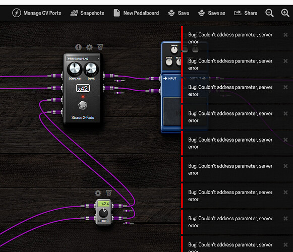

It’s not just that I can’t reach the host, though. Even internally, communication doesn’t always seem to work properly:
This message is not from the browser. This is from the MDX web server, what seems to be Tornado.
This is another common mistake. Maybe a topic for support after all?

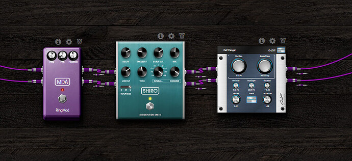

Current:
The behavior is independent of the loaded board.
Incidentally, I also already had the problem that while I was dragging a plugin onto the board, the “Frontend” could no longer communicate with the “Backend”. Unfortunately I forgot the error message.

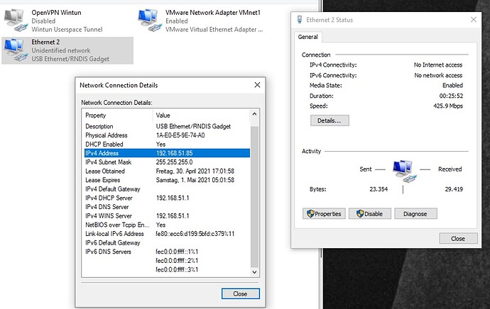

I took the time and tried to figure out the problem. At least on the Windows side, everything seems to be fine.
Ethernet adapter Ethernet 2:
Connection-specific DNS Suffix . :
Description . . . . . . . . . . . : USB Ethernet/RNDIS Gadget
Physical Address. . . . . . . . . : 1A-E0-E5-9E-74-A0
DHCP Enabled. . . . . . . . . . . : Yes
Autoconfiguration Enabled . . . . : Yes
Link-local IPv6 Address . . . . . : fe80::ecc6:d199:5bfd:c379%11(Preferred)
IPv4 Address. . . . . . . . . . . : 192.168.51.85 (Preferred)
Subnet Mask . . . . . . . . . . . : 255.255.255.0
Lease Obtained. . . . . . . . . . : Friday, 30. April 2021 17:01:58
Lease Expires . . . . . . . . . . : Saturday, 1. Mai 2021 05:01:57
Default Gateway . . . . . . . . . :
DHCP Server . . . . . . . . . . . : 192.168.51.1
DHCPv6 IAID . . . . . . . . . . . : 460232030
DHCPv6 Client DUID. . . . . . . . : 00-01-00-01-27-92-3C-A0-68-84-7E-7A-AD-38
DNS Servers . . . . . . . . . . . : fec0:0:0:ffff::1%1
fec0:0:0:ffff::2%1
fec0:0:0:ffff::3%1
Primary WINS Server . . . . . . . : 192.168.51.1
NetBIOS over Tcpip. . . . . . . . : Enabled
The network is in place and working. I can also successfully ping the IP address 192.168.51.85.

192.168.51.85 is your local machine IP assigned from the Duo, you need to use 192.168.51.1 to ping the device.
Haha… I stupid. Yes, you are right.
The connection via the IP instead of the name works. I am relieved…
Thank you!
It would still be interesting to know why the name resolution suddenly no longer works …
