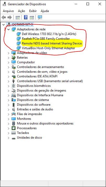

@rogeriocouto do you have an android phone? if yes, can you try enabling USB tethering please? (should be under extra network options).
The driver that windows uses for android phones usb-networking is the same that MOD needs.
So perhaps this way we can know if your windows install includes the driver or not.
Thanks! I will look into it but first I will follow @falkTX suggestion and try to find out if my system has the correct driver or not.
Hello @falkTX,
I Enabled the usb tethering on my android phone. Here are the results:
What should I do next?
