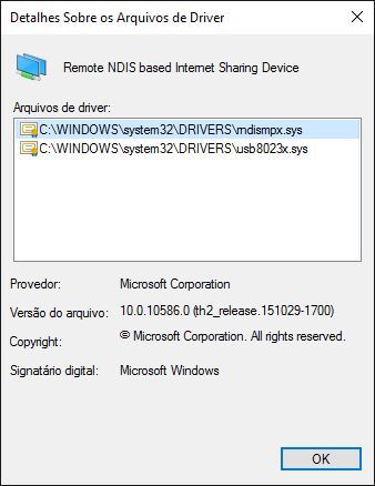

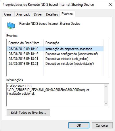

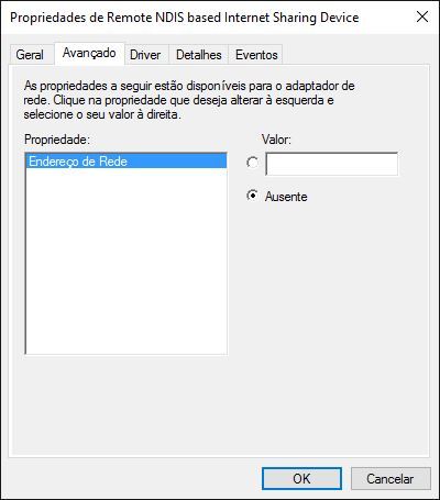

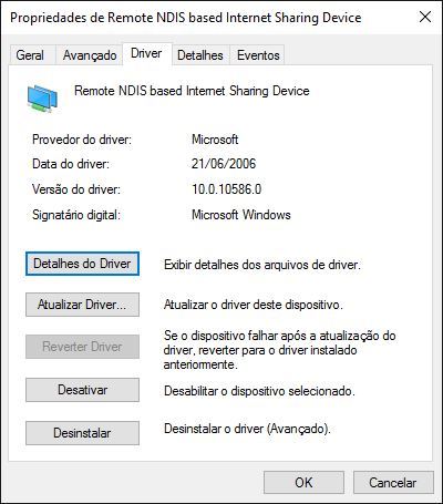

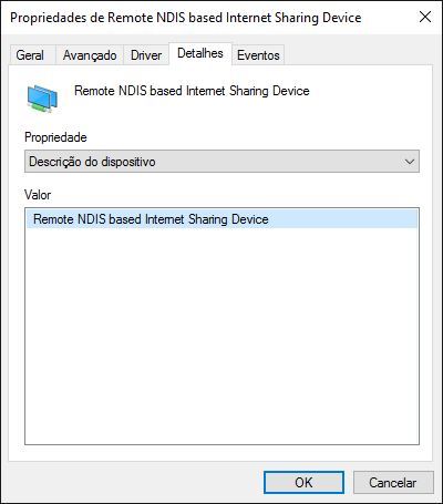

Here are some screen shots…
maybe it´s better you Tell me which kind of info do you need.
@acunha Following the suggestion of @falkTX I´ve found that my system has the RNDIS driver installed but it´s using another driver for the MOD DUO.
I´ve been searching the web to find a way to make windows 10 use the correct driver for the MOD DUO without success.
I´m out of ideas…
