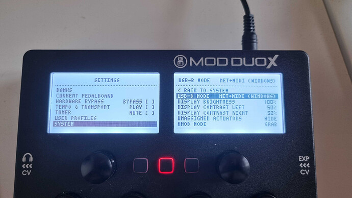

can you say how did you get in this menu ?
Push and hold down on the left knob, use the left knob to scroll to settings and push, use the right knob to scroll to USB-B mode and press down then scroll across to net+midi (windows)
Sorry I missed one step!
settings>system>DEVICE SETTINGS>USB-B Mode>Net+MIDI (Windows)
there is no usb b the menu inside there starts with display brigthness display contrast left display contrast right unassioned actutators
Oh sorry, that was just added in 1.12 which is supposed to release this week.

On a Duo X with 1.12 installed, there are some settings on the device itself regarding USB mode.
With an updated Windows 10 and 11, you can switch the device USB mode to be “Net + MIDI (Windows)” which is known to work better than the default network only mode.
The side effect is that in this mode macOS (and iOS on iPad) won’t be able to see the network connection.

I actually tried switching to ‘Net+MIDI (Windows)’, but when I use this mode, my Windows can’t recognize mod duo x at all when I plugged the usb port.
Could update status of my Windows 10 (Haven’t updated for a while) be a reason Windows can’t recognize normally?
(It’s a shame I spent 5 hours trying to fix it but haven’t seen the pedalboard in GUI web in Windows yet…Really wanna see it ahah)
yes, early windows 10 builds still did not support composite usb devices, which is what the net + midi mode uses.
