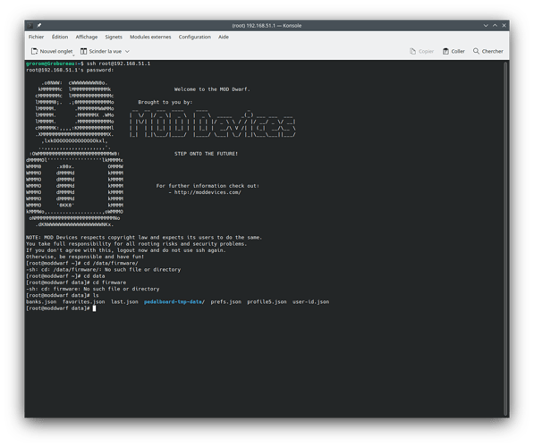

Hmm, I have no /data/firmware/ folder on the Dwarf on RC3 ! A clean-up command line in the update had wiped this folder ?
I’m unable to copy anything to the Dwarf, at firt it seams okay :
(Temp.zip contains rtl8761a_fw.bin + rtl8761b_config.bin + rtl8761b_fw.bin + rtl8761bu_config.bin + rtl8761bu_fw.bin)
But in the Dwarf I don’t see anything :
Not sure it’s a RC problem, I have not test this before ! (never had the need)
