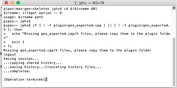

Yes I understand the action of the setup.sh but the files are there :
And here is the terminal:
Problem with the second line ?? :
dirname: illegal option – b
Any idee ?
on this case you are showing, the first cd is wrong, as that is meant to be used only inside the script (so it gets into the path where the script itself, and thus the repo, resides).
ok, so which directory should I point to ?
