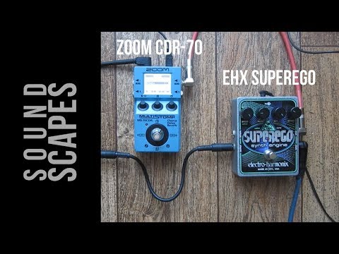

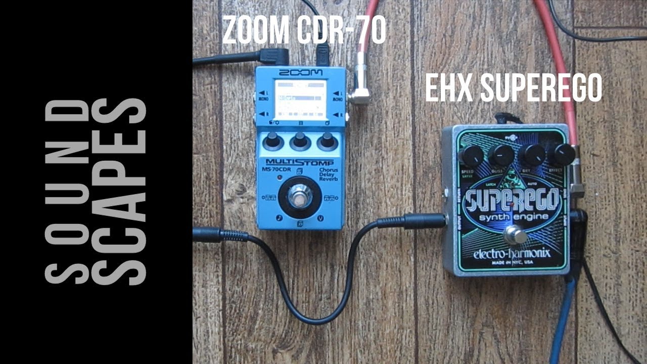

Here is an example of how Auto mode works in SuperEgo (just watch the very beginning of the video). You take a chord, activate the pedal, the first chord freezes, then you take the second chord (or note), a trigger is activated by the volume, the pedal itself kinda “presses the switch” and freezes the second chord, releasing the first frozen one. They smoothly flow into each other (and not just by a fade, but a so-called gliss, with elements of pitching).

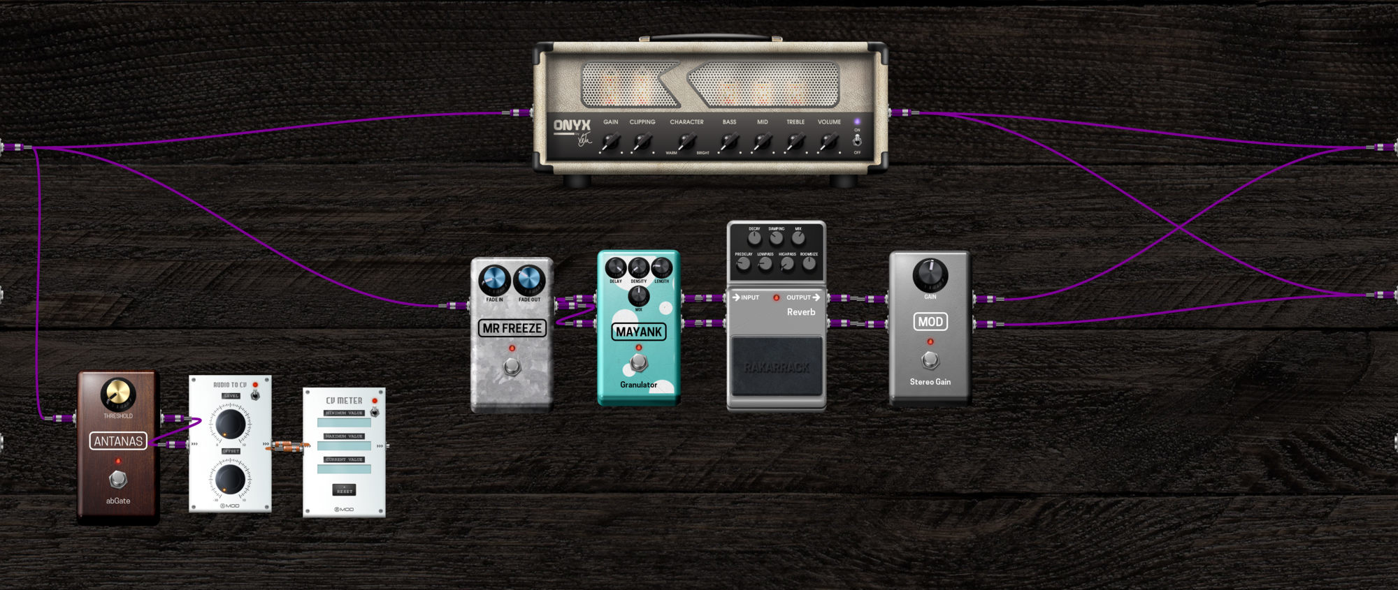

Here is my attempt to achieve similar (auto) behavior of freeze. I use another plugin here (Mr Freeze) because i guess not everybody have locally installed Freezer right now. But CV scenario is the same and can be used with any plugin. You strum, freeze activates by CV (momentary). Strum again - it freezes another portion of sound, releasing first one.
