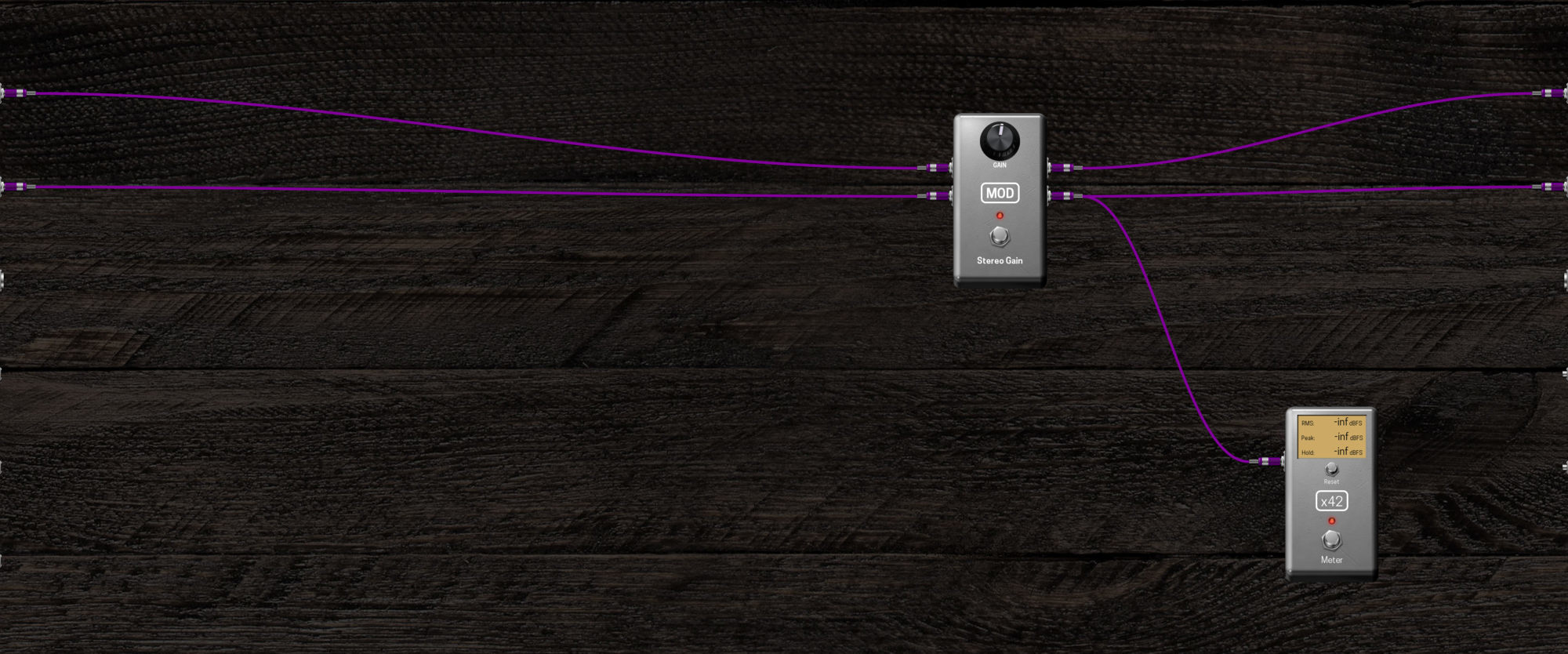

it ~seems~ like that GUI updating issue is related to the breaking CV issue… but the stalled GUI update issue happens even without any CV in a pedalboard, as here:

@S_Righteous i’m happy to go ahead and file a bug report, if you like. but first, can you confirm that none of this is an issue when you run untethered? …and also please confirm that you do see the meter stall in that last pedalboard i linked.

I just tested the meter_stall pedalboard.
If I alter the volume, the meter does pause, but only briefly, it does not stop and wait a long period like we saw the sequencer do with my pedalboards. As a metering plug-in, it could easily appear that this is expected behaviour.
But if I keep altering the volume - then yup, it freezes while the knob is moving, so you can keep it in a state of stall by always moving the volume knob. That seems wrong and new.
agreed… and same behaviour as i see.
