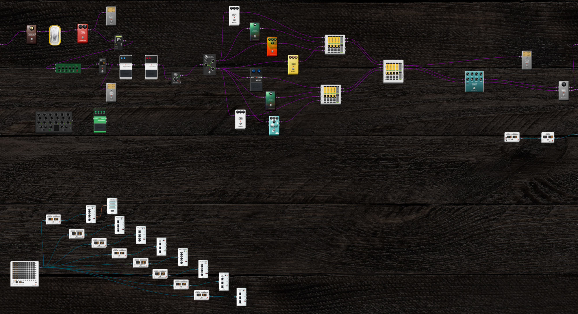

When all this happened, I was working on a complex pedalboard which used a lot of CV signals. I half wonder if something in that pedalboard caused something to break, which needs to be reset. I can send a version of that pedalboard to you.

Plutek - since you are experiencing the same issues as I am, would you be kind enough to test out a pedalboard for me and see if you have the same CV overload issues I have also experienced? I’m not sure how to privately share a pedalboard though.
I was working on a complex CV set up which had issues, when I found the separate issue with the Control to CV plug-in. So I focussed on that in this thread. I wonder if both issues are related.

So there is a looper, you can throw in anything, radio, vocals etc. Then a sequencer sends CV on and off signals to two mixers so that the looper gets chopped up into 8 parts. My final goal is that an octapad will trigger those.
There is a pitch shifter added. You can just listen and hear that the loop has each 8th note muted/unmuted. If you adjust the pitch shifter rapidly, like from 0 to -12, then the sequencer will overload, and then you hear that the CV did not mute the loop where it should have, but a few of those parts stay open - the sequencer visually stalls as well. The sound of this may not be obvious depending on what you chose to loop.
The pitch shifter is just an example to send a signal which overloads the CV. I was using some other processors and noticed that the CV would get interrupted as well.
