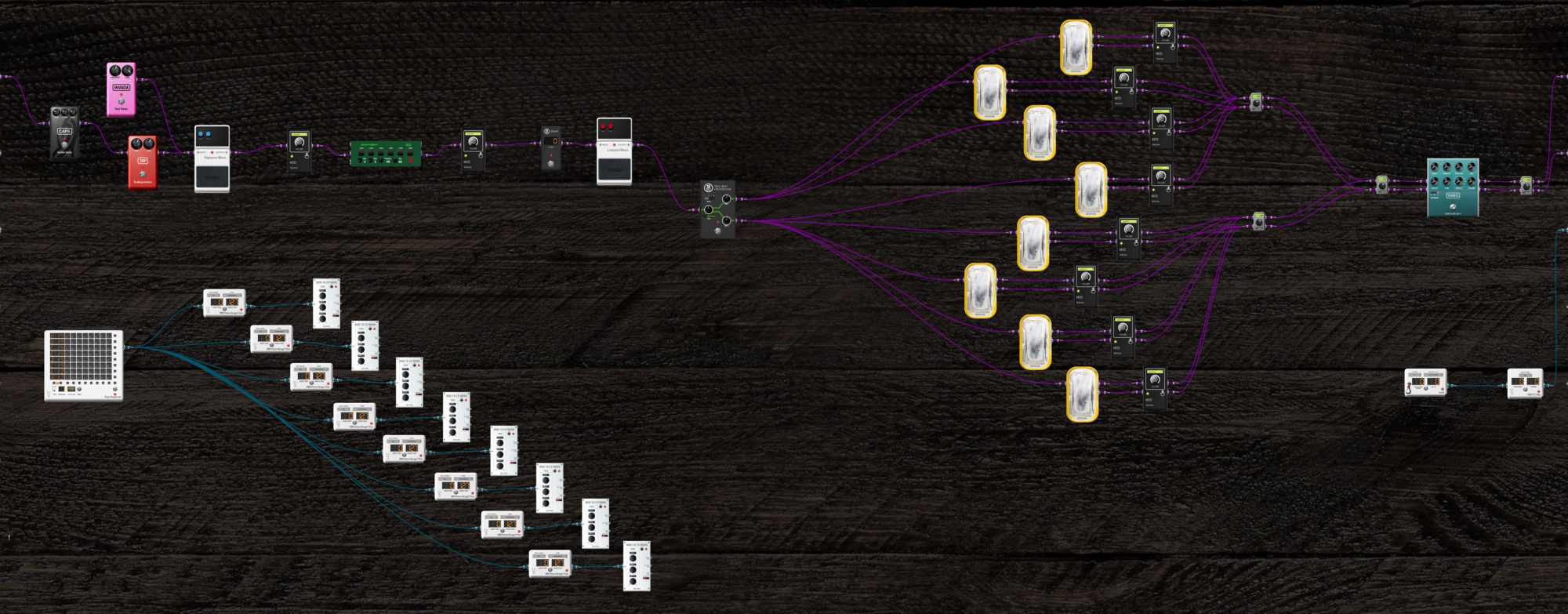

I made a more simplified pedalboard for testing. This should make it clear that there is no one specific plug-in which is causing this issue. If you use the test tone with this pedalboard and then adjust the pitch, or volumes of the signal paths, you will eventually cause a situation where the CV does not work, and a gated signal is no longer gated. The sound of that happening is quite noticeable.
I use the pitch plug-in, but other plug-ins in it’s place will cause the same issue - so it’s not the plug-in being controlled by the device, it’s that “any” plug-in being adjusted could cause this failure. A simple volume adjustment is not CPU heavy, but it can fail when you adjust a volume using the knobs on the device.
I ‘think’ that this is a CPU spike of some kind. But it’s hard to tell.

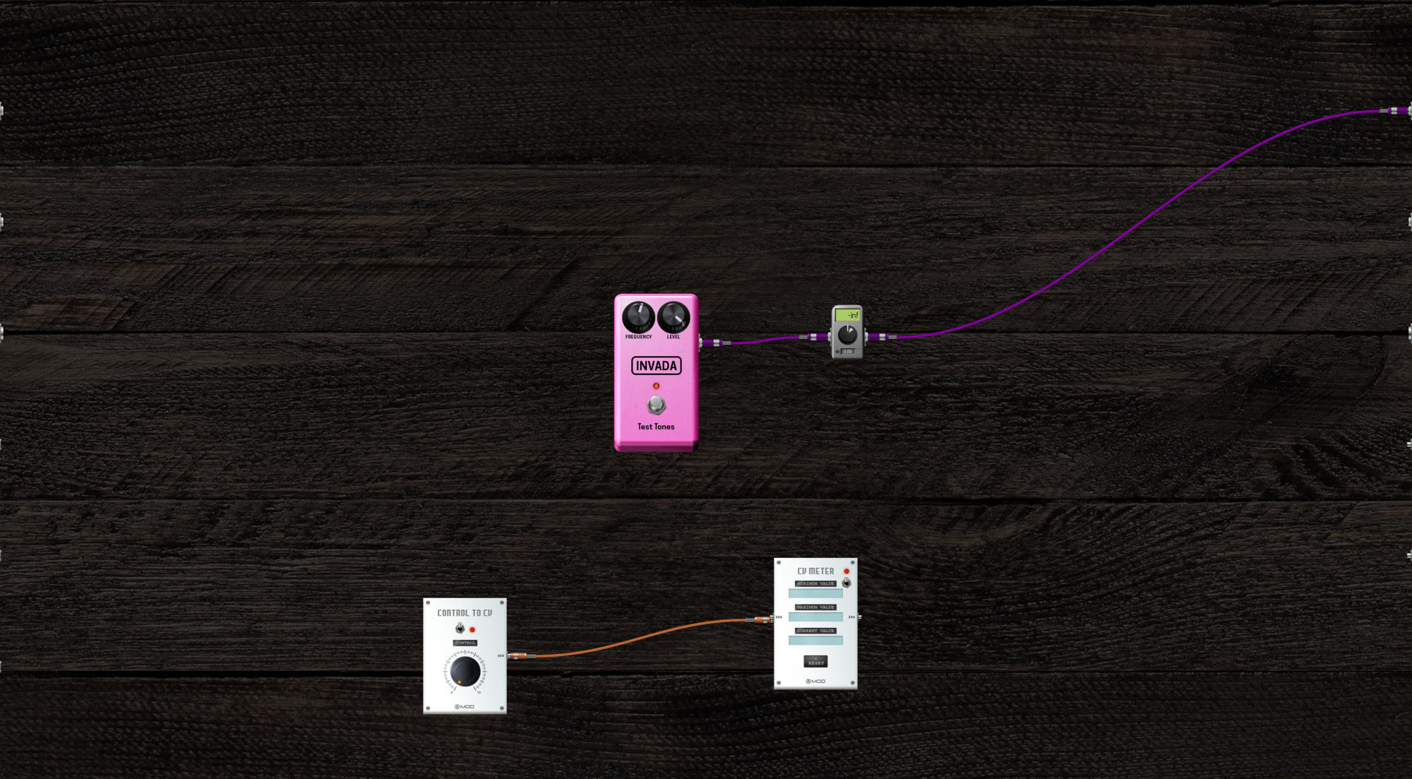

ok, here’s a very simple pedalboard which shows the issue, as i see it:
on my Duo X, i see that when i adjust the Test Tones level using the hardware knob assigned to the Control to CV plugin, neither the CV meter nor the Tiny Gain meter updates properly while the knob is in motion. however, they do update during motion, if i move that knob with the mouse in the browser GUI. in both usage scenarios, the desired volume adjustment of the Test Tones is operating properly.
@S_Righteous can you confirm that you see this issue as well? …and does this correspond to what you’re trying to report? …i think it doesn’t, because you’re saying that you hear problems (i.e. it’s not just dysfunctional metering for you)?
@falkTX is this metering problem a known issue? if not, i’ll file a bug report.

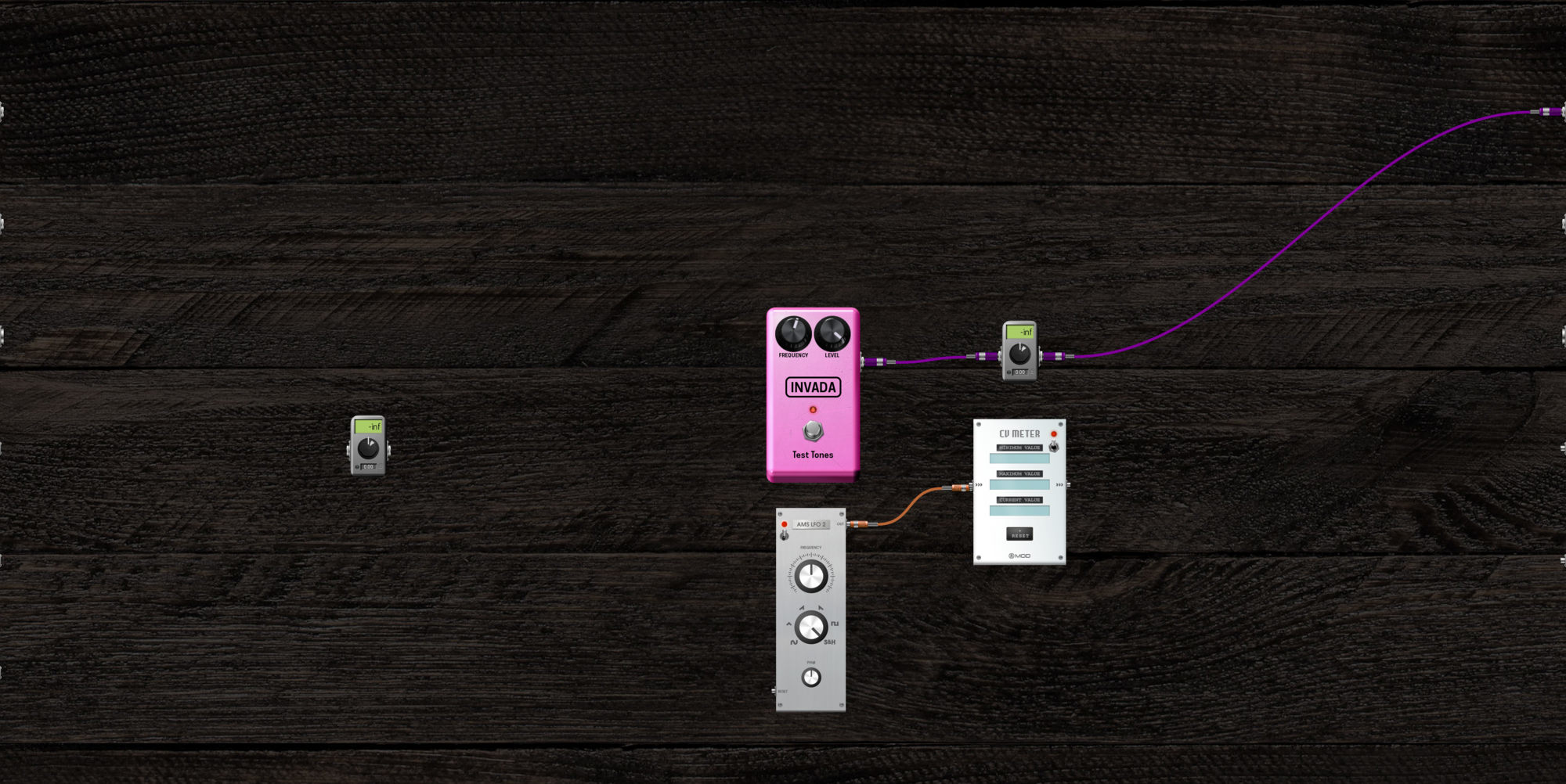

and here’s another test board:
[N.B. for testing, please turn on the LFO plugin in this board - i had to turn it off to get the screenshot to generate]
so, here we have a case in which the two meters show changes which are caused by a CV LFO. the lefthand Tiny Gain is assigned to a hardware knob. even though this plugin is not connected to anything and it has no involvement with any of the CV on the board, both meters stop updating when that Tiny Gain knob is adjusted via the hardware knob to which it is assigned. again, the meters seem to be fine when the plugin knob is adjusted directly in the GUI.
this behaves similarly on the Dwarf (if i assign that lefthand Tiny Gain knob to a Dwarf hardware knob), although on the Dwarf the meters also stop when that Tiny Gain knob is adjusted via the GUI.

My original pedalboard had unique processing on each of the 8 gated channels (you think this one was fun!) - so it overloads more frequently, with less effort. I have been running various melodic, vocal and random input into that one, and recording the results. Rapidly altering a value, or altering two values at the same time with the device knobs will cause it to crash. But even altering one value slightly ‘can’ cause it to crash eventually. For noise music this random crashing sounds fine, but yeah, it’s not intentional.

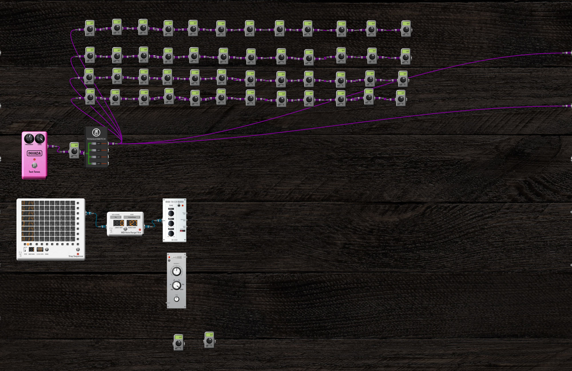

take a look at this board:
  1. start the transport rolling (leftmost Duo X button) - that gets the sequencer running, which toggles the switch via CV, producing an intermittent output tone.
  2. twiddle the two upper-right knobs simultaneously (these just operate the non-functional Tiny Gains at the bottom of the board) - watch the sequencer to make sure it doesn’t move, because the CV gate will only fail if the realtime-updating GUI elements DON’T CHANGE for a while.
  3. the CV gate will fail in about 5 seconds.
  4. go into the parameters of the Toggleswitch and change the CV trigger for switch 1 to “1 lfo” - you’ll see that this fails as well, so this bug is not only related to a (sequenced) CV gate.
  5. also, if you start disconnecting the Tiny Gains at the top, one row at a time, you’ll gradually get to a point where it’s very difficult to keep the realtime GUI update from happening once in a while (you’ll start to see the sequencer jump slots) - if that happens before CV fails, it seems that the system recovers enough to prevent CV failure.
