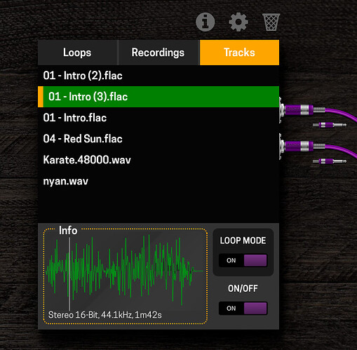

To share some progress on the audio file plugin so far, cause why not, everyone likes updates.
  • initial working modgui to test the needed concepts, works well but needs adjustment
  • can load any file that libsndfile supports (the basic open/permissive ones like wav, ogg, flac) plus mp3. I will try to add even more file support at a later point (through ffmpeg library)
  • supports looping
  • syncs to host transport
  • disk-streaming if file >30s, otherwise loads it entirely on RAM
  • always runs in stereo mode
  • tested to on work on all units
some notes:
  • duo doesn’t particularly like big encoded files on non-48kHz sample rate, loads them but takes a few seconds
  • there is a big difference between loading a 48kHz wav file, or something with 44.1kHz (resample needed) or even flac/mp3/ogg encoded stuff. best results are obviously 48kHz wav since there is no decoding or resampling process needed
  • looping does not time-stretch/pitch-shift or anything like that to fit into the global BPM. this is not a looper, just a player
  • currently in the beta store for those with a MOD Dwarf. if you try it, let me know how it works for you.
    (for everyone else, please be patient as we are fixing the last 3 known bugs on v1.10 Duo/X platform)

oh and a picture yes!

Hi falkTX. I’ve installed the plug-in on my dwarf but I don’t have a clou how to open any files. So I’ve put them on the root directory of an usb-stick. Is this the right way or do I have to make it another way?
This is better done in a different plugin, something dedicated for loops.
In some months if there is nothing else like this yet, I will make one myself.
You need to use the file manager tab to upload your files.
It is a new separator on the bottom left.
