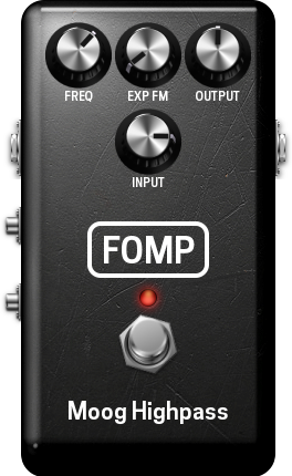

Of these, the Tal-Filter-2 is the only one that’s continuously variable, but there doesn’t seem to be a way to set the frequency, only the resonance and an LFO rate and depth. The FOMP Moogs are great, but I’d be back to manually blending between them. The AMS VCF is almost perfect, but the filter type controls are discrete, not a crossfade.

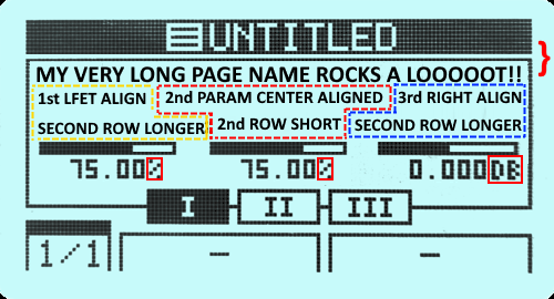

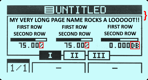

Would be useful to give a custom name to pages and show it somehow.
In my case, a have an amp on path A and same amp on path B. I like to have gain on knob 1, volume on knob 2 and treble on knob 3. I use this configuration on page 1 and page 2 but I have no immediate info about if I am on path A or B (I have to memorize that page 1 is for path A and page 2 is for path B).
Or maybe we have two plugins with same parameter names but I find difficult to recall if parameter on page 1 is from plugin X and parameter on page 2 is from plugin Y. This would be more complicated if you use more pedalboards. Parameter name customization is not that helpful since name length is limited. A workaround would be to let a parameter name to use not used space of other unused slots but this would work only if we use less than 3 parameters on a page, but it’s just a kind of workaround. Adding a custom page name would help a lot.
Moving the measurement unit on the right of the value would make room for a full row for page name
Reducing the vertical space between title bar and main area and reducing the parameter bar height would make room for a two rows param name.
Reorganizing sections and vertical unused space we could have a first row for page title and two rows for parameter name.
I agree that there are dead space that could be exploited but you have to be careful because all that text clustered together may be difficult to de-cypher once you are standing up playing your instrument on a live stage with the lightshow going on around you.
There are many factors that needs to be taken into account when designing screens for devices like this such as the type of font used in this case seems to be “Fixed”, meaning that an “i” takes the same amount of pixels than an “m” in width. This limits the number of characters you can put on the display.
The second issue is that these screens are low resolution and the pixels are bulky. Because of this, there is not many font sizes that can be used before all becomes unreadable.
As shown in @redcloud’s last screen mockups, I don’t think the size of text in the yellow/red/blue areas would allow for that many characters since the mockup uses proportional characters instead of fixed.
Of course the character used is not right but the idea of doubling (at least) available characters remains. Descriptions would help when you have to turn the knobs and a that time you are near the device, shouldn’t be a problem to read smaller fonts (unless you want to turn knobs standing because of your 6 ft long arms :smile: )
This would not be a good idea with the displays used. The small font on these displays becomes almost completely useless. If I remember correctly, they’re 128x64 pixel displays. This doesn’t leave very many pixels for small fonts…also from a UX/UI design perspective it is not very pleasing or practical. Less is definitely more in this case. Just my 2 cents
It’s not a matter of using a smaller font but to use unused empty spaces leaving font size untouched.

I like the idea, but if you look at the size of the current ‘large’ text, it’s actually 5 pixels tall. I don’t think you can actually get any smaller than that - but yes, you may be able to squeeze another line in with all the suggestions you gave.

It is 7 pixels actually. Again, I’m not talking about decreasing the font size but just about optimization of unused space.
We can save 2 more pixels by restyling the top bar
I was referring to the parameter text, not the title text at the top.
I wasn’t suggesting you were saying make the text smaller really, just that I question whether you can fit three rows like in your yellow/red/blue mockup. Maybe a second row.
