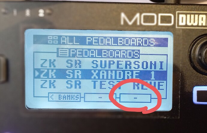

Snapshots are important to me because depending on where you’re playing and in agreement with the sound engineer you have to change effect parameters and it has to be able to be done quickly and saved. So:
  • Yes, like I do on the WebGui but on Dwarf: I save first the snapshot, then the pedalboard.
  • I don’t see any “save as” function on the Dwarf, only “save”. If I save with the same name , the screen show me: “Are you shure you want to overwrite the current pedalboard?” and a “confirm” or a “cancel” option. If I save with another name, it creates another pedalboard outside the current Bank, visible in the ALL Pedalboards list.
About my Bank problem, ok, I just understood that I was doing something wrong, but I find the procedure to add a PB to a Bank too complicated (too many steps, 9!) for a live use :
  • Bank
  • scroll to bank
  • Enter
  • Scroll to " Add PB to Bank"
  • Select
  • Scroll back to “All Pedalboard” (that’s the step i was missing so far…)
  • Enter
  • Select
  • Add
Suggestion to simplify it:
An " ADD TO" option :
  • ADD TO
  • Select the bank
Et voilà…
Let me know if you want me to add a new topic about that in the “feature requests”?
