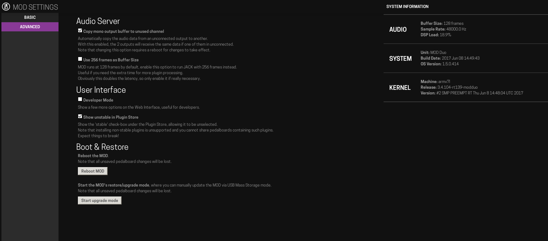

For those curious about the settings page, this is how it looks so far.
Requests for specific small settings should be done now, if you wait too long it might get too late :slight_smile:

First of all: Congrats to another fine alpha version. :clap: Since you asked for feedback on the settings screen:
  • I would move the “system information” to a separate branch instead of having them next to the settings (avoid cluttering the screens by showing the same information)
  • the system information could also include the status of USB devices (lsusb in a table)
  • … and about Control Chain devices
  • for new (and forgetful) users, tooltips would be helpful: what does Jack Manager do? Is it the same as the remove Mix Server? … and why are neither of these under Audio Server?
But yeah, probably splitting hairs… looks already excellent.

I don’t understand what you really mean here.
[quote=“eggsperde, post:11, topic:1372”]the system information could also include the status of USB devices (lsusb in a table)
… and about Control Chain devices[/quote]
Sounds useful. something that shows all connected devices. hmm..
[quote=“eggsperde, post:11, topic:1372”]for new (and forgetful) users, tooltips would be helpful: what does Jack Manager do? Is it the same as the remove Mix Server? … and why are neither of these under Audio Server?
[/quote]
If you don’t know what these are, better leave them unchecked.
Maybe I should move them to Advanced. Then Boot & restore can come to the basic tab.

on the settings page:
  • services moved to advanced, boot&restore moved to basic.
  • the reboot action was not working properly (need to wait for HMI to reset first)
fixed the beats per bar issue reported above.

With branches I meant the top-level entities on the left side.
branches = ["basic", "advanced"]
branches.append("system information")
:smiley:
You’re right, of course, if one does not understand one should not enable/disable settings in the options. But still, it would be good to explain them… make people interested in experimenting with their hardware.

How about adding a “Settings” button to the UI?
Build 423 is here:
  • fix enabling pedalboard presets (regression after temposync)
  • work-around for the cut-off MOD display images (finally! :heart:)
