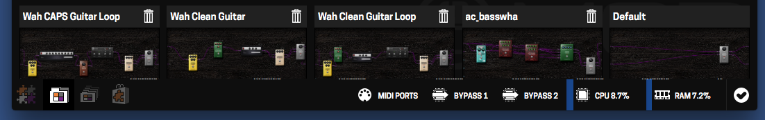

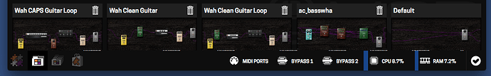

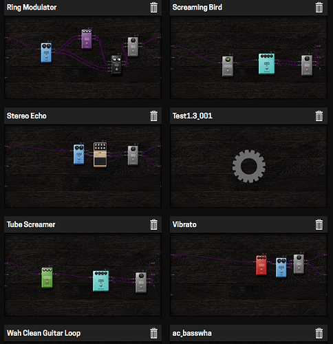

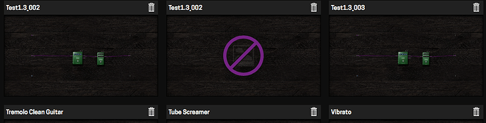

Saved another pedalboard and now have this, more spinners and now all delete icons are gone. Clicking in the correct delete area does work so its just missing images:

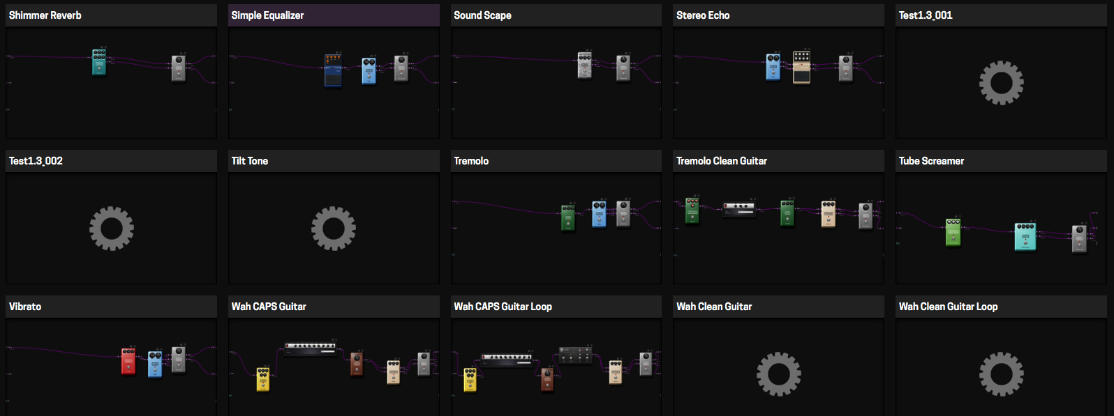

Also regarding your issue with the spinning wheel on the pedalboard thumbnails, fixed for the next build too.
Seems like having 2 pedalboard screenshots being generated at once blocks the entire thing…
Found an alternative way to handle the situation, so things will continue to be smooth after a pedalboard save now.
That, or you might have turned off your mod while it was rendering the thumbnail.
Or and error too in some other area.
That symbol just shows the thumbnail is missing.
