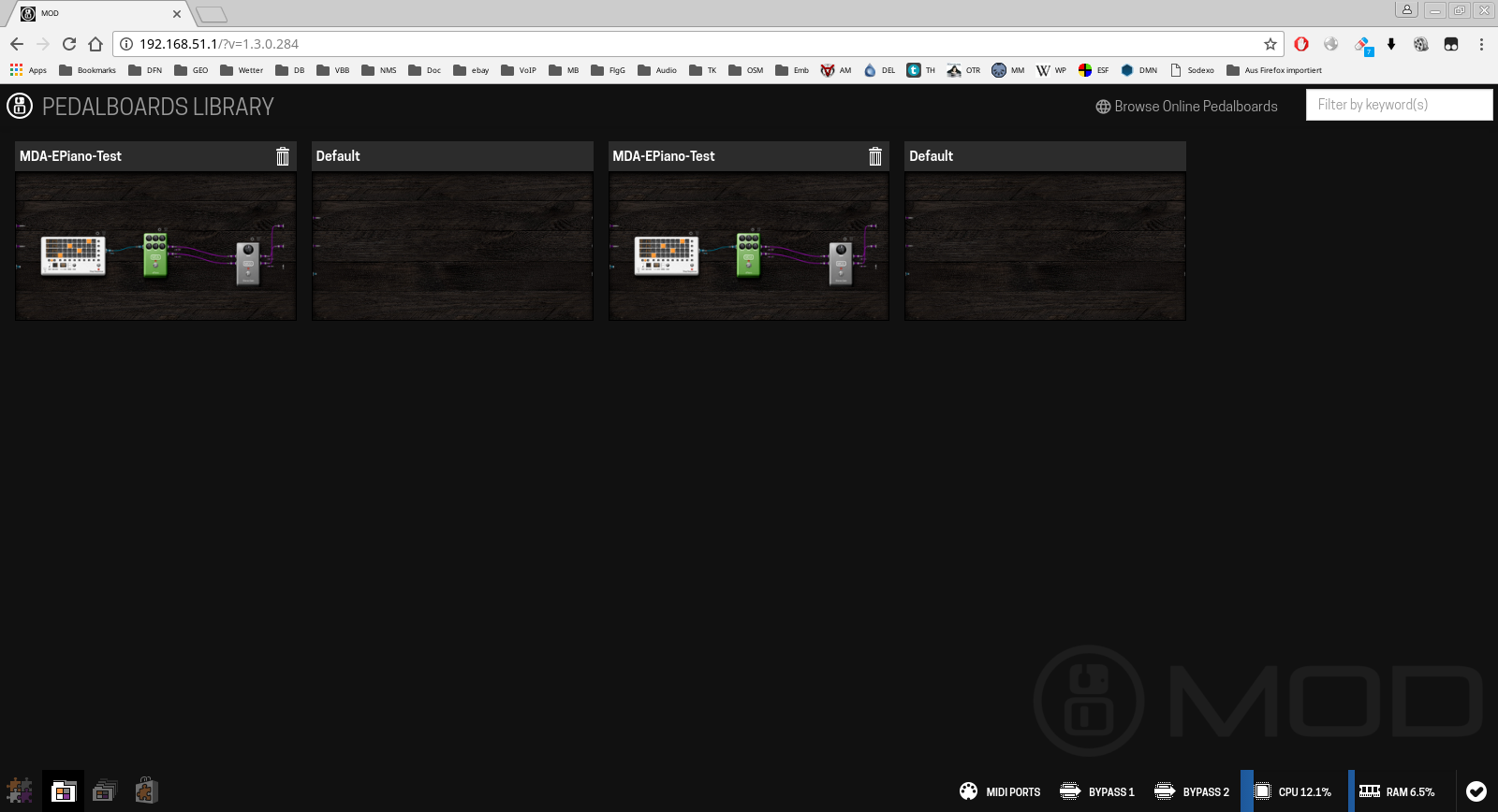

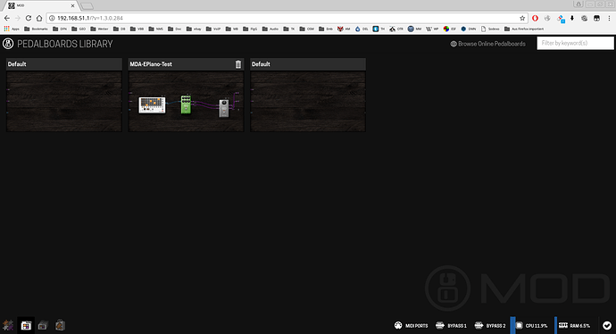

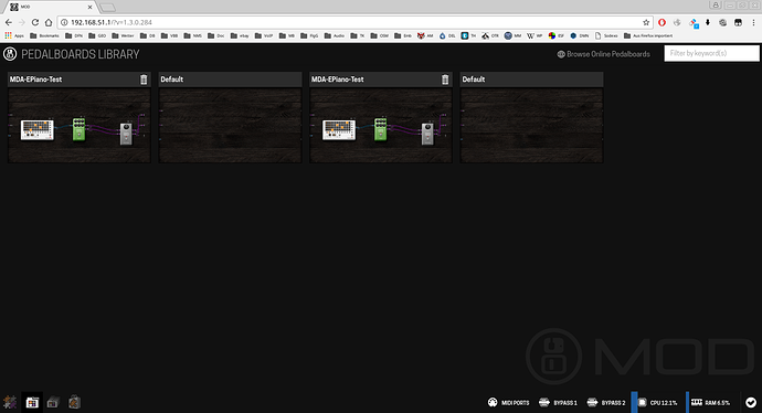

Storing pedalboards: I have no pedalboard stored, no banks created. Fresh boot. Create a simple pedalboard. “Save” it. When switching to my “Pedalboards Library” I first see the default board doubled and when going back and again into the library I see also my fresh created one doubled:
Removing my created pedalboard removes only this board from the library view and after switching back and again into the library the default pedalboard is shown (not doubled). When I repeat the whole process and delete one of the doubled pedalboards and click on the left one and endless “Loading pedalboards…” starts (only (browser) reload helps).
