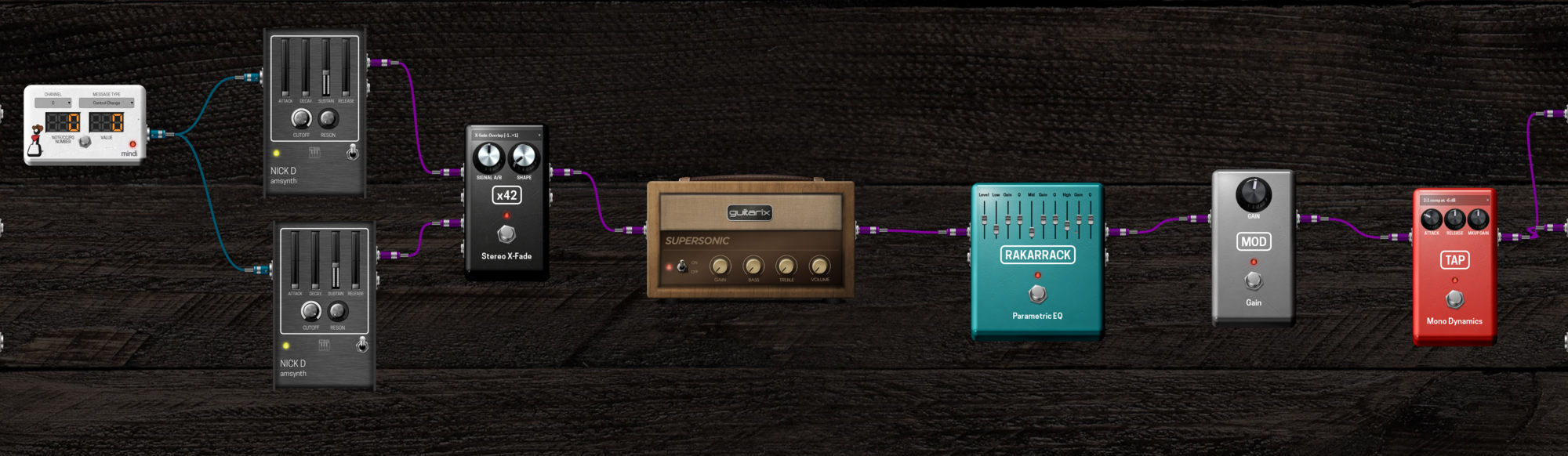

this first one requires 256 frames. it usually sits at ~70% cpu, but spikes to 100% (accompanied by 3-5 xruns) every minute or less:

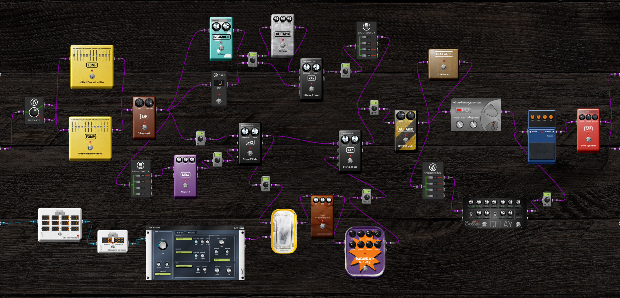

this one is particularly interesting, because it has no beta plugins and runs at 128 frames with a load of ~60%. still, it consistently spikes (with xruns) 2 or 3 times in an hour:

the second one (cart_of_flowers) has no input at all – it’s just a generator.
the first one normally has input, but triggers the xruns regardless of whether input is present or not.

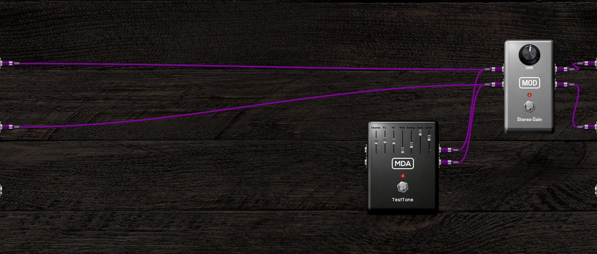

also… i’m just now running a test with a new pedalboard (just the default with only a stereo gain plugin). it is showing 1 xrun after having been running for about 1hr30min. i didn’t actually see when it happened, so can’t say whether the cpu usage spiked or not. i’ll leave it running and keep reporting… is this sort of long run of a minimal board something you’ve tested?
ok… at this point, that new default board has been running for 6hr30min and i have accumulated 4 xruns.
i’ll leave it running overnight, and give you a new total in the morning…
…after 17 hours, i have a total of 7xruns.
next, i’ll try to capture both video and audio for a long time, to see if the cpu % is spiking, and if the dropouts are affecting the audio…
ok… i’ve observed the cpu spiking to 100% (accompanied by 3-4 xruns), just after an audio discontinuity, a number of times now. it’s happening every 1 to 2 hours on this minimal pedalboard – i added a tone generator so we could see what’s happening to audio but the xrun and cpu spike count is very similar to a default new pedalboard:
here’s a short video of one of the events:
MOD_cpu_spike_movie
…you can see and hear the audio discontinuity at about 8 seconds into the video, followed by a cpu spike to 100% at about 8.5 seconds. this is typical of what happens periodically.

Note that the “CPU spike” is not real. We fake that when an xrun occurs, because JACK2 gives an average DSP load rather than the “worst-case” value (which is more useful).
The CPU is not randomly going to 100%, BUT we do have random xruns in that case yes.
The good news is that we do not see those sporadic xruns with the mainline kernel.
