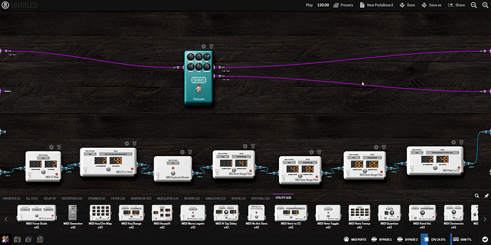

If you are not too picky about the exact value it is probably the easiest to assemble a chain like in the screenshot below, translating the CC into a note, discarding all values that you are not interested in, and transforming it back to a CC.
Hope that helps you out a bit, you can always get creative with different MIDI filters, although it will require some thinking ahead usually. If you find a better solution, be sure to let us know! :slight_smile:
