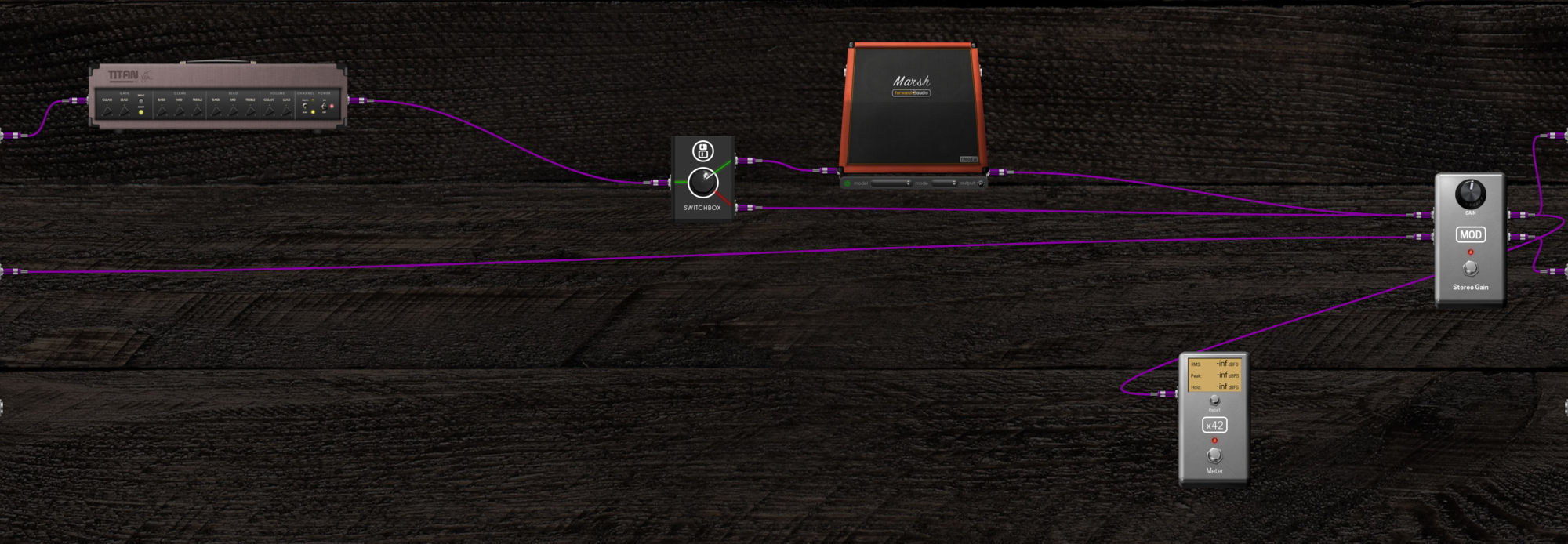

@Sharry as far as I see in your pedalboard you don’t have any cabinet emulation.
This is not really the ideal setup for using this plugin since it doesn’t come with built-in cabinet emulation. “Weird” harmonics are expected when you use plugins like this without a cabinet emultation.
Believe me it is the same problem with a cabinet. I noticed this effect with a purchased March1960 Cab
It was recorded with a Strat with passive PUs.
At first I thought it might be the built-in distortion pedals until I deleted the whole pedalboard in installments.
It would probably get me into a discussion about every plug-in here,
Therefore it was my intention to send you a PB only with one plugin.to show the issue.
Whether it is an ideal setup is not up for debate here.
What do you think about trying it yourself?
Why did I send you the PB? What else can I do now?

@ Jon, now with Cab . Different but still unusable.
Of course the sound changes with a CAB (otherwise it would also be a bad investment).
The lower octave of the E- string still can be heard when playing the power chord. .
By the way, harmonics by definition always have a higher frequency than the base note.
I don’t know what style you play. I wanted a powerful, smacking metal sound, so I can’t use these artefacts.
Obviously, other users also have a problem with this plugin.
I think I have now invested enough to inform you about this bug!
Why this Question. I specified the version and state of OS in the bug report.
Empty Km in communication again.
