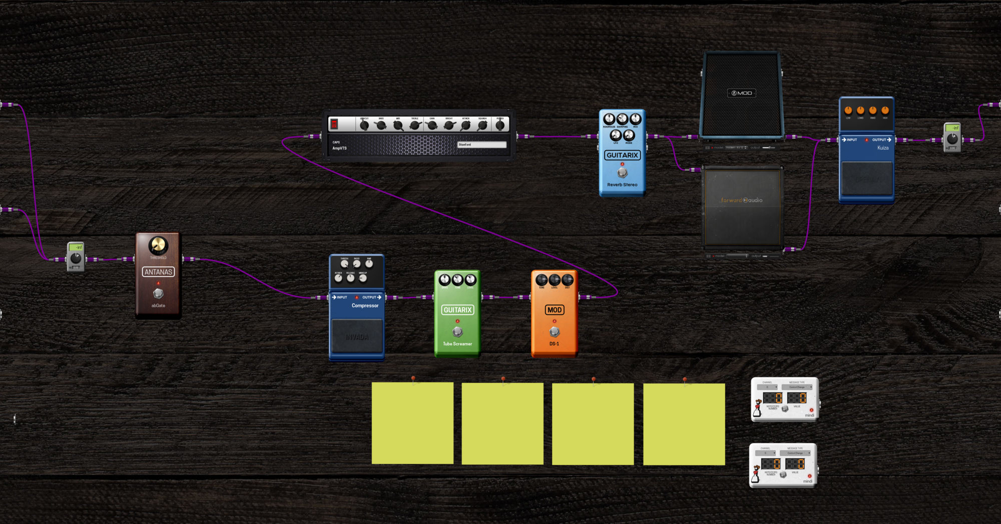

In search of an adequate metal sound I rummaged in the pedal board box and found an interesting recently published board which also explains the mysterious MINDI. (thanks to dncrash!)

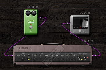

Again, the board produces a deep ghost octave playing power chords on the low strings. (second snapshot)
Is it possibly a systemic problem? :thinking:
