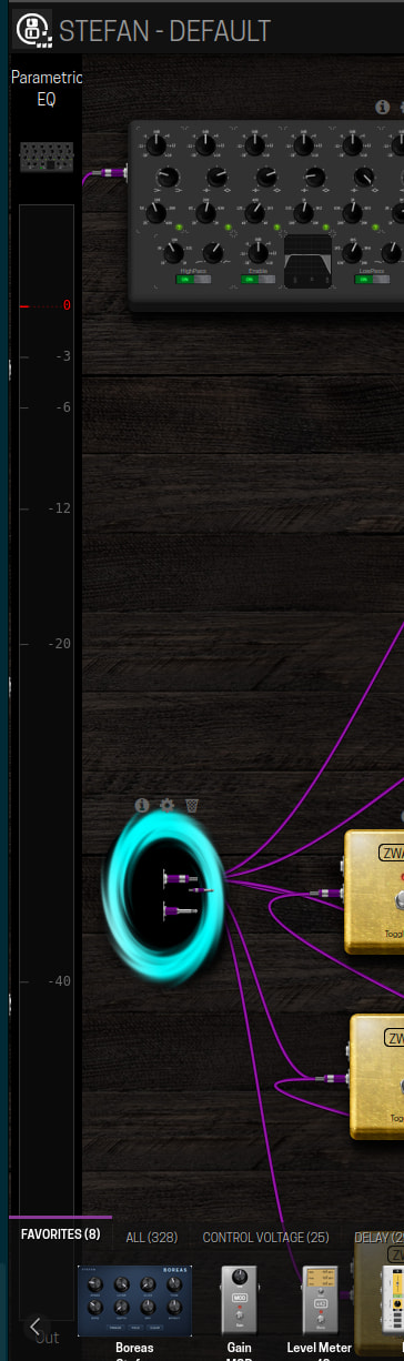

@AndreaDelSignore I tried the per-effect output level monitor on my Dwarf pedalboard. When I clicked to remove the monitor from an output it reappeared by itself, in the end I had to switch to a different pedalboard and back again to get rid of the monitors, but the global monitor is still stuck on the left and I don’t know how to remove it completely. Could you help me out on how to disable the global monitor since it also hides my inputs on the left?
Edit: it went away after a reboot, so there is some solution to get rid of it
I have had this a few times, a browser refresh seems to work for me. Did you try that?
I get this as well, I think it is maybe something to do with being able to drag a new plugin to replace another plugin (the sort of curved arrows on plugins that can be replaced)?
There’s a bug but it’s intermittent. When you’re stuck with just the global monitor without any other output monitor just refresh the browser to get rid of it (shift + f5)
