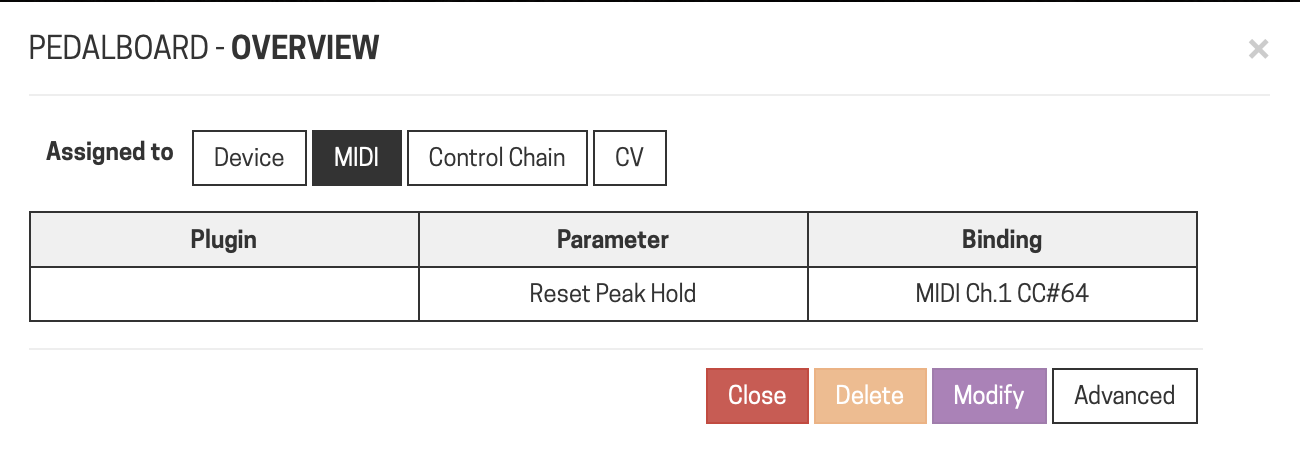

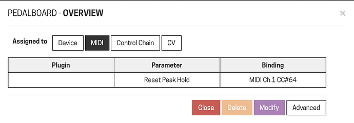

Hi @AndreaDelSignore
I have noticed that the plugin names are not being displayed in the bindings for midi and CC.
This started a V12 bit I’m not sure how it can be anything to do with what I did?
binding.pluginLabel = binding.plugin.label ?? binding.plugin.effect.label
The problem seems to be that binding.plugin.label is not null, it seems to be an empty string. So the correct value in binding.plugin.effect.label is not used.
HI @AndyCap,
yes it’s for sure that line of code. please open an issue, I’ll take care this WE.
