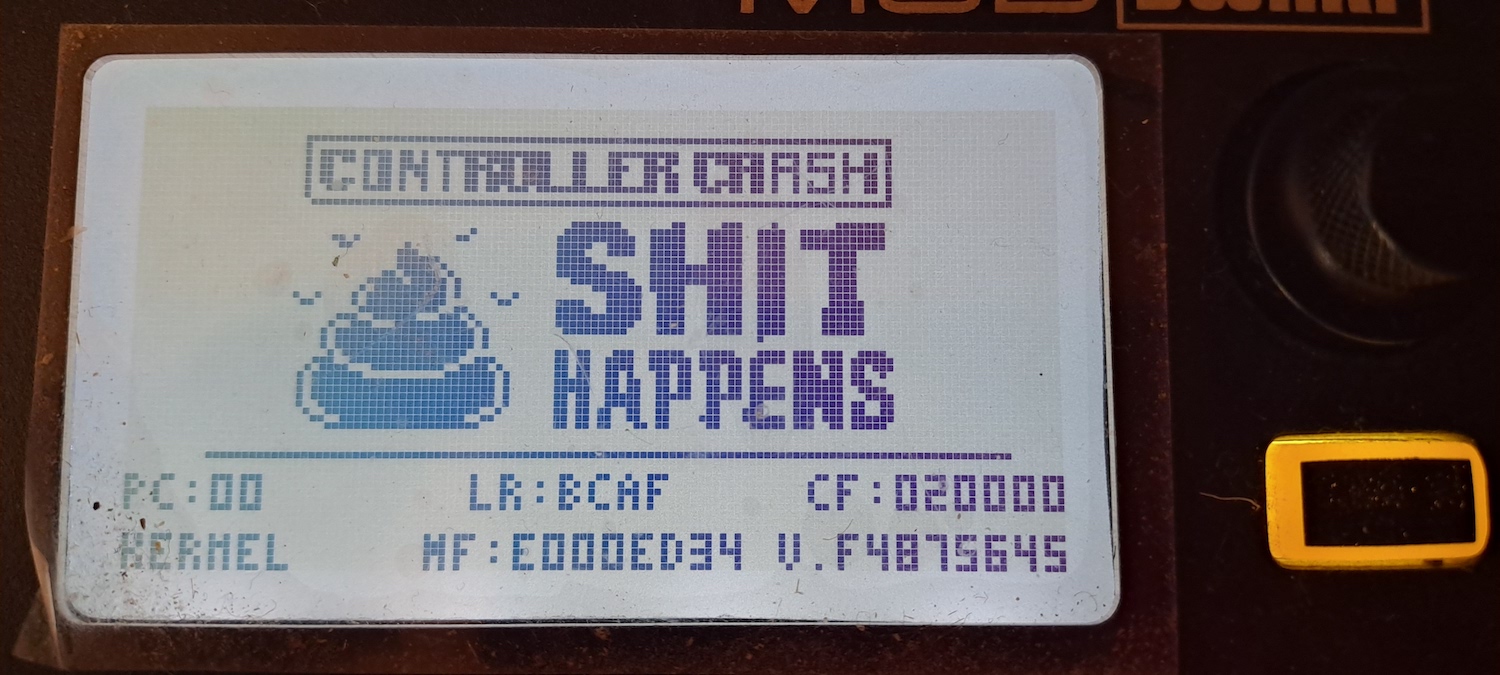

Just one crash so far, here is the picture if it can help:
Both the screen and the footswitch LED color contain important details that can help with debugging.
Hi,
PC = 00 → NULL reference
can you reproduce the crash? can you give me some more context info?

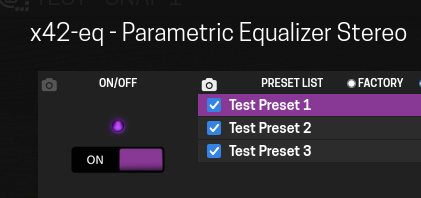

EQ presets don’t change when I switch between snapshots. Other plugins (on my board) load their presets correctly. I tested with EQs from x42 and RKR (but not with every other plugin there is).
I can reproduce it reliably. Make two snapshots, each with its identifiable EQ preset. Switch between snaps. The EQ preset saved with the snap is not loaded. If you manually load a preset and the switch snaps, the preset stays the same.
I checked with the original firmware which works as expected.
Hi Andreas,
sorry but I can’t reproduce the bug.
Can you recheck your settings, because snapshots management is a bit different with starless firmware, than the original one.
More details here: Snapshots parameters configuration · sejerpz/alabs-mod-custom-images Wiki · GitHub
Anyway this is the checklist:
  1. Check that the “preset” parameter is controlled by snapshots (press the small camera icon on the top-left corner near “preset list”)
  1. Check that every snapshot has the right preset associated: select the snapshot, check or select the right preset and save the snapshot
  2. Save the pedalboard: this is important!
Have a nice day,
Andrea
Thanks Andrea for taking the time to check and respond!
Yesterday, having confirmed that everything worked using the original firmware, I switched the Dwarf off. First thing I did today was reflashing Starless 11. Everything still works. I haven’t touched any snapshot or preset or configuration. The parameters config was the same when I tested yesterday as it was today after reflashing.
I am happy that it works, of course, but I don’t get it. This reminds me of the situation (a few posts up) when I couldn’t remove plugins. I post about something not working, I restart ( or in this case reflash) and it works… :thinking:
