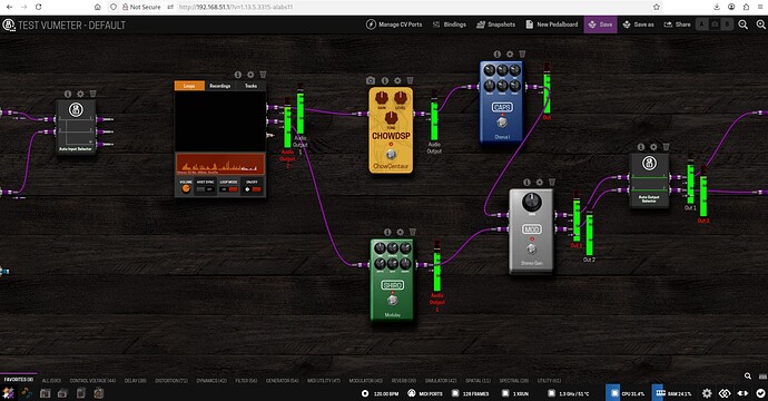

Hello everyone,
Just a quick update! My plan for the next few days is to squash the minor bugs we found and then push out a bugfix-only release (alabs11)
After that, I’ll be working on an alpha version (alabs12a) that includes @AndyCap’s contributions and a first POC/implementation of audio level monitoring (which is why I need to update mod-host).
Here is a look at the first UI prototype. There is still plenty of work to do, to monitor a port, just SHIFT + CLICK on a output jack.

This would be an insanely useful feature!
I have only a suggestion/feedback (if you may allow me :slight_smile: ): Somewhere, a button that allows activation and deactivation/hiding of the meters. I’m thinking that, although the feature is nice and super useful, sometimes it can clutter the pedalboard when you are in a stage where you don’t really need it anymore.
I have only conflicting feelings about how the show/hide should work:
1st: a button eventually on the Status Bar for meters after all plugins
2nd: on a plugin basis, so you click on some button on top of the plugin that shows/hides the meter only for that plugin.
I see pros and cons for both implementations.
A third option that I thought of now, while thinking that the stereo output plugins would add a new layer of cloughing here: a meter that appears only when you hover over the output (likely harder to implement). Perhaps with a mix of the 1st…so activate that on the status bar and when you hover over the outputs, you can see the meter…
Sorry…maybe I started ideating too much while typing :sweat_smile: but I really see a huge plus on the feature itself!

Hi @jon,
I have only a suggestion/feedback (if you may allow me :slightly_smiling_face:)
I’m posting these POCs to get early feedback :slightly_smiling_face: so feel free to comment or brainstorm — that’s exactly the goal.
I have somewhat conflicting feelings about how the show/hide should work:
We’re aligned on what you wrote. My current thinking is that we actually need both approaches:
  1. a global enable/clear functionality, which is especially useful for small pedalboards
  2. a more fine-grained one — but not at the plugin level, since when doing this kind of analysis you usually want to follow the audio signal path
I ruled out hover-based interaction, as I don’t think it’s very practical to move the mouse back and forth while playing.
There’s also a more complex case to handle: when two outputs are connected to a single input, we would need to sum the dB levels from both sources. For now, I’m not planning to implement this.
Even though it’s not strictly necessary right now, I’m also considering adding a dedicated UI button for better feature discoverability, and to prepare for the future implementation of approach (1).
In summary, the next release will focus on approach (2). Here’s a quick overview:
  1. SHIFT + click toggles the output port VU meter
  2. Click selects a VU meter and shows its value on the global (larger) meter
  3. Double-click resets the clip indicator (a VU meter with a red border indicates clipping)
VUMeter Screencast

Great! That’s really nice of you :slight_smile:
Yes. When I wrote " on a plugin basis" I meant after each plugin in the chain. Not just the plugin per se, but everything on the chain up to there.
I can agree. Especially if you are physically playing something like a guitar, that implementation would be pretty useless.
Yes. And here I could even see some kind of notification or something letting you know that you actually have two “cables” connected to one input (although this is somehow a side thing). Due to the magnetic nature of the virtual cables, a lot of times users end up connecting two cables to a single input when they do it in smaller/standard zoom and they don’t even know that they did it.
Do you mean this particular feature?
It sounds great!
That looks great! And the way that you access it as well.
I just didn’t quite understand one thing (although I think using the feature would make it clear really fast): the main/big meter on the left shows the audio level on the master output? Can show just after some plugin? And if yes, how do you distinguish between the two?
Thanks :slightly_smiling_face:
That happens to me as well from time to time. Definitely something to think about, but it’s outside the scope of this feature for now.
Yes — I mean a button to enable a sort of “place a VU meter” mode. This could be especially useful in a touch context where a keyboard isn’t available.
In the future, that button could also be extended with a popup menu like:
  • Inspect audio (place a VU meter as it works now)
  • Add a VU meter to all audio connections (gloabl adding)
  • Clear all VU meters
This would support approach (1) — the simpler, global one.
No, the big meter follows the currently selected VU meter. You can click on any “small” VU meter to display its value on the big one.
It’s basically a zoomed-in view of the selected meter.
Right now, the label at the bottom updates to match the selected VU meter port. However, I’ve noticed that many ports have generic names like “out”, “Audio Out 1”, “Audio Out 2”, which isn’t very clear.
I’m thinking about showing a small preview of the effect the port belongs to, to make it more intuitive.

fair enough :slight_smile:
That actually sounds like a great plan. I never think so much of the touch screen approach since I don’t use it that much, but definitely worth it.
gotcha. It makes sense. Does it also somehow increases resolution of the meter? Meaning, can you check the level more in detail?
Exactly, I guess that was what led me to not understand it from the video.
That could work. Or the name of the effect and “out 1” or “out 2”
