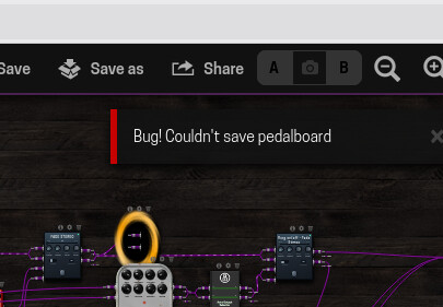

  • I couldn’t save the pedalboard… loading another one and reloading the precedent resolve the problem

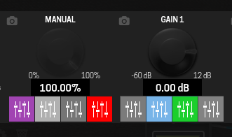

  • we could have different colours when a parameter is assigned to device, Control Chain, MIDI or CV :
    (for exemple here, assigned on : the device | midi | device + midi | device + midi + CV)
    Or maybe more readable :
  • when we delete an assignation, the window is closed. Is there a wait to avoid this and keep the windows open ?

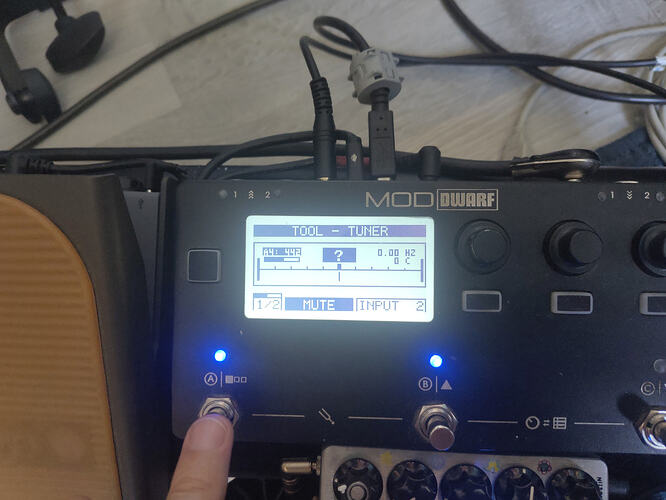

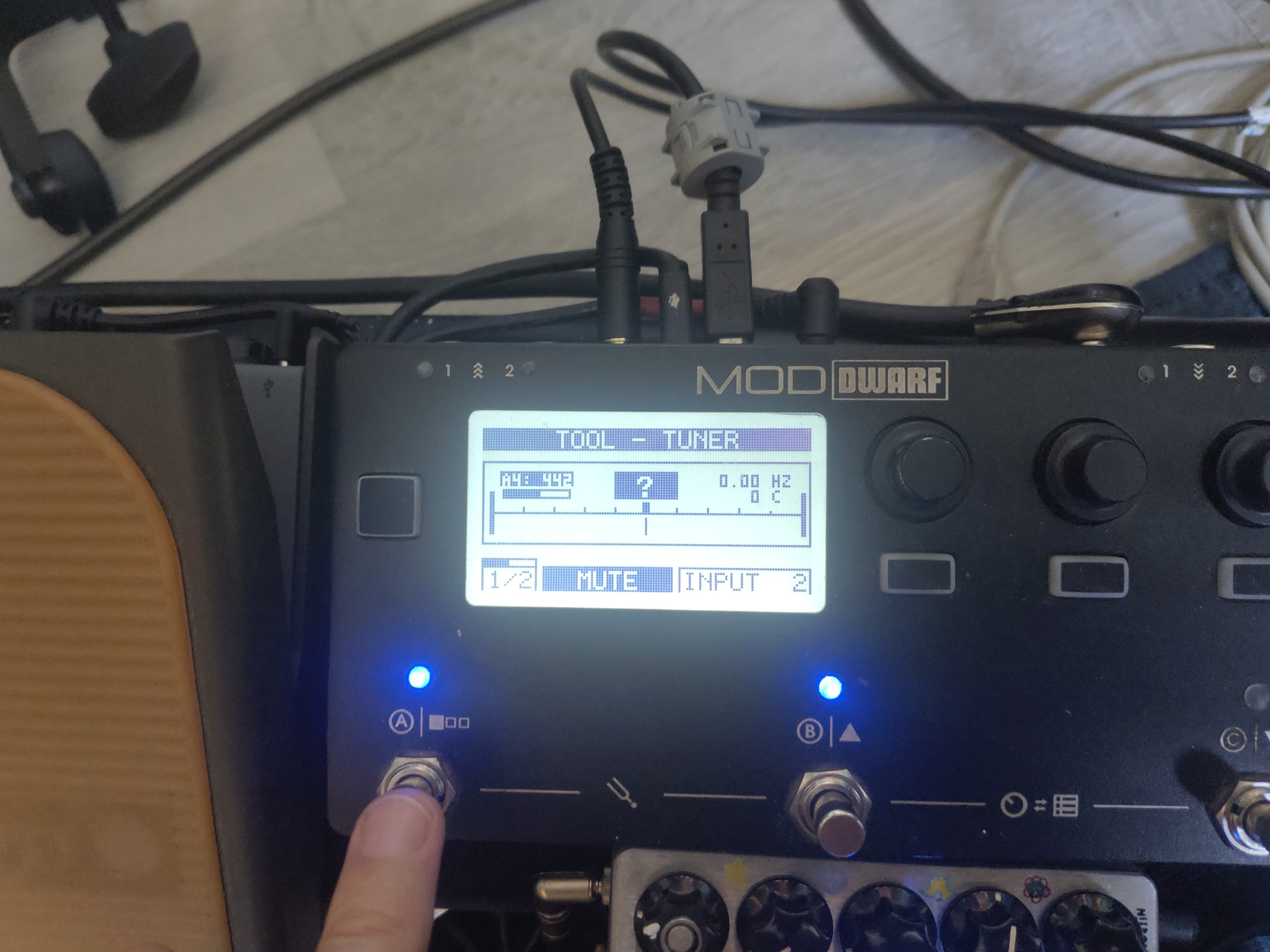

Oh a good one easy-reproducing, when I go to the second panel of the tuning menu :

mmm, I can’t even get the tuner activated here. I have no idea what is going on here, let me try to work out what is going on.

An error on the top right corner of the webUI, it was like : “Bug : can’t save the pedalboard”
I’ve tried multiple times, with different pedalboard names, with save and save as. Than I change pedal board it was ok to save. I came back to my main pedalboard and it was okay since then !

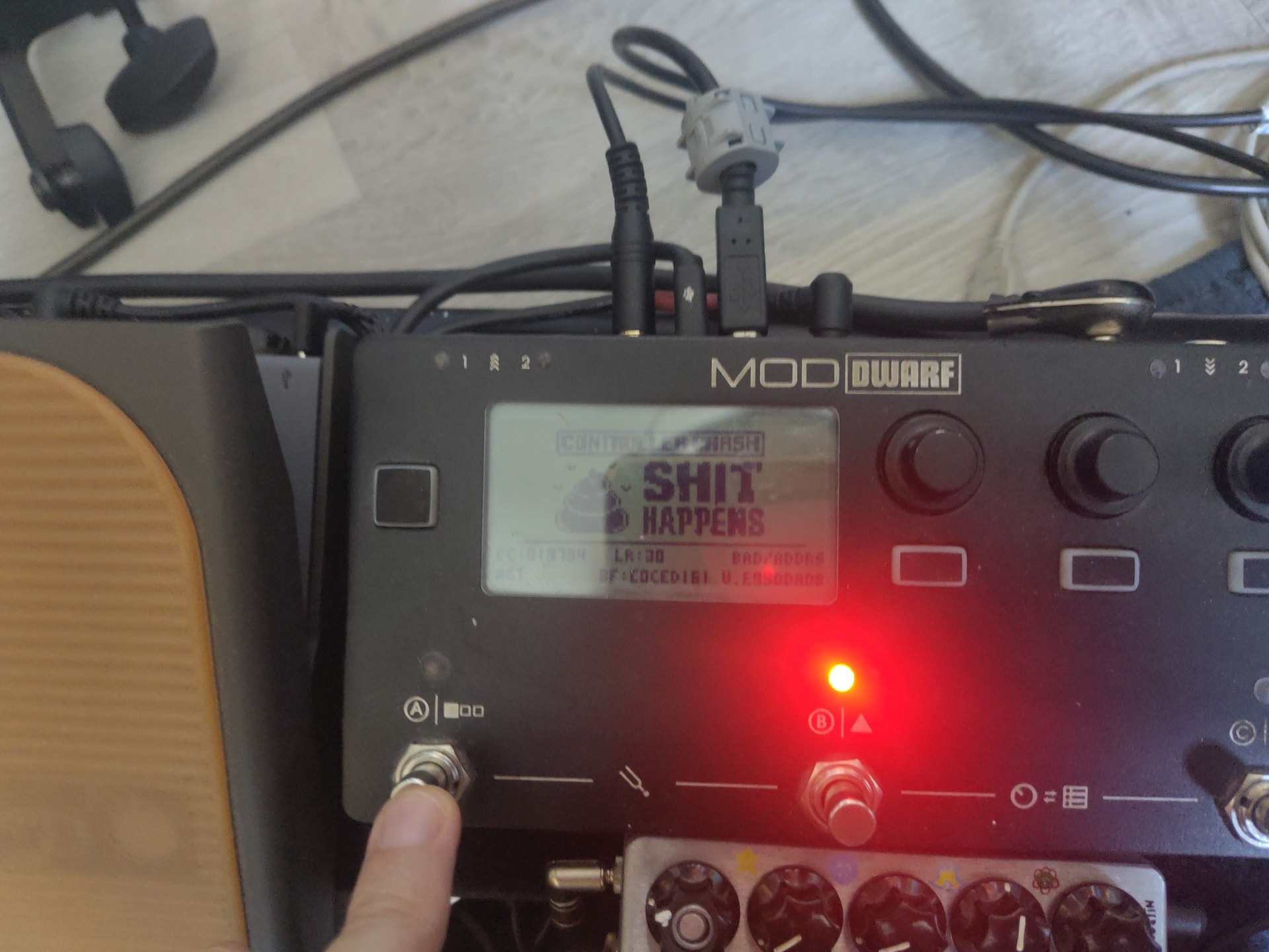

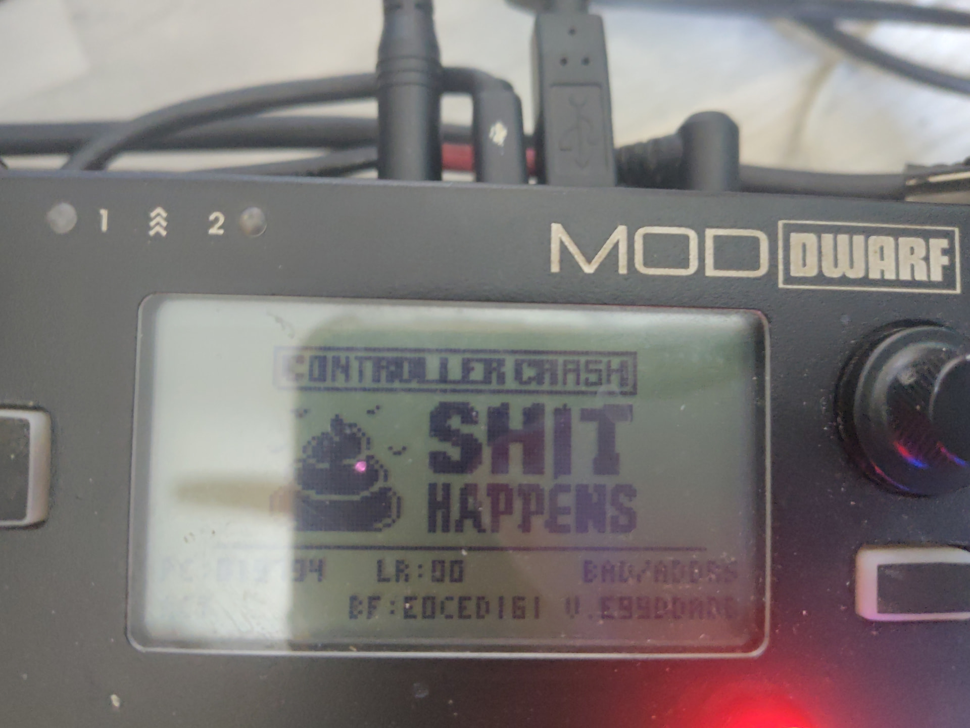

Something terrible seems to have happened to my Moddwarf, the A and C foot switches are not working!
Put the original mod software on, same problem.
Looks like first job in the morning is taking it apart to see whet is going on!

I moved the moddwarf and disconnected the Control Chain Mod Footswitch to do some testing, A & C started working again! So something weird going on there.

It’s perfect : no more LED problem, sync midi is working, I can go to the TOOL TEMPOon the device ! Thanks !
I had the “Bug : can’t save the pedalboard” at the 1st save after booting with the new firmware, but not after loading a new pedalboard… strange, but not a big problem.
Well that should not be happening, there must still be a bug there. I couldn’t replicate this but thought it was to do with changing the enable/disable with a pedalboard loaded which is one of the reasons I disabled that.
I’m pretty sure it’s the python code but if it happens again, can you look at the browser console log and copy it here. What browser do you use?

If this happen, when I click again on “Save” the name proposed is blank and I have the same “Bug! Couldn’t save the pedalboard” each time.
