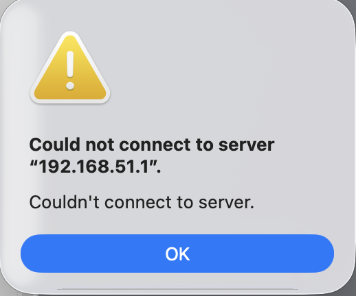

SSH fails me on a new MOD Dwarf, founders version.
I’ve used Transmit for many years; now it fails to connect.
(I did MOD factory reset & updates)
Termius also fails

Can anyone spot what I’m doing wrong?
And tell me how to fix it..

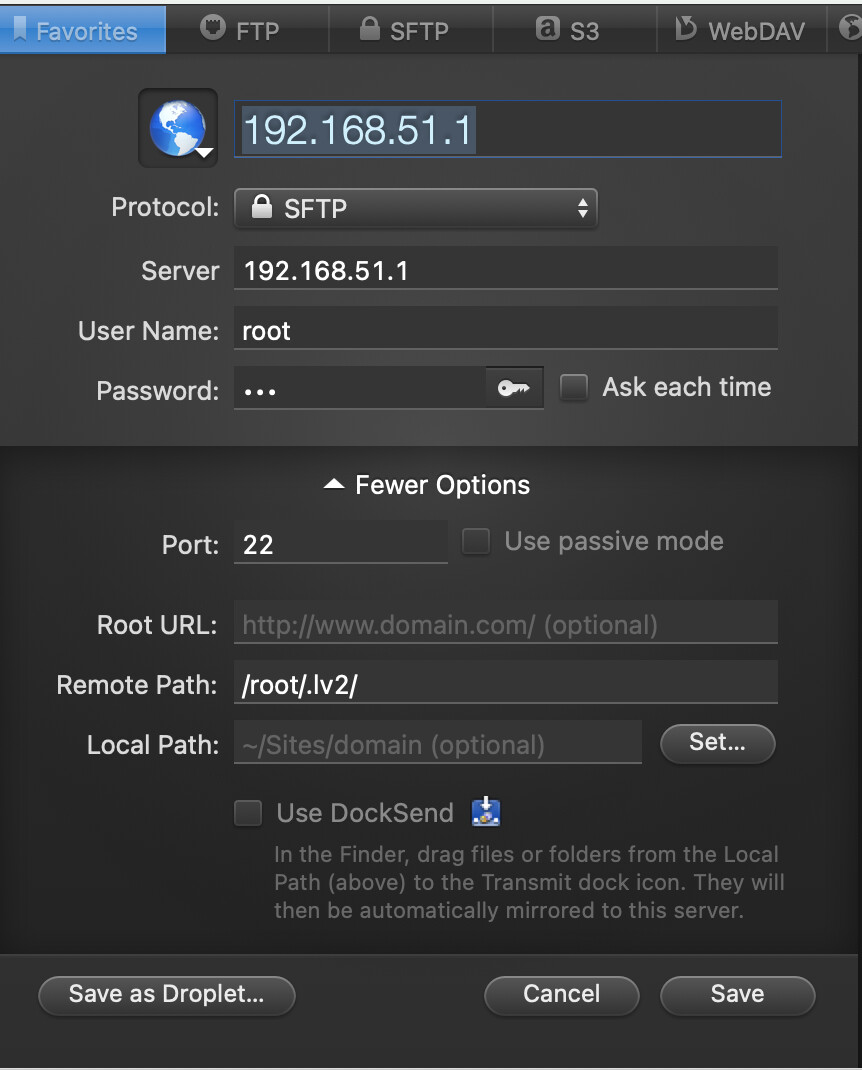

Transmit:
Holà,
Does your connection with the web browser works ?
With 192.168.51.1 ?
What is you OS ?
It seams like there is a wrong key store on your keys folder…
Oh and, il your screenshot I would have put on the Server line “Mod Dwarf” and on the Root URL line “192.168.51.1”, but not shure, I don’t know this software

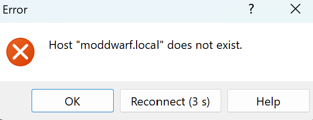

  4. I tried “moddwarf.local”
    as well as “192.168.51.1”

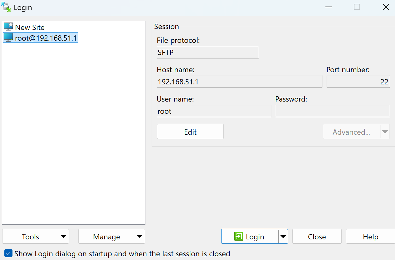

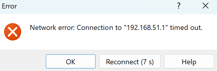

Borrowed a Windows laptop,
installed WinSCP;
same result..
don’t forget to change the connection mode in the settings when trying windows (can’t find screenshot of exact name)
connection mode = SFTP
…isn’t it?

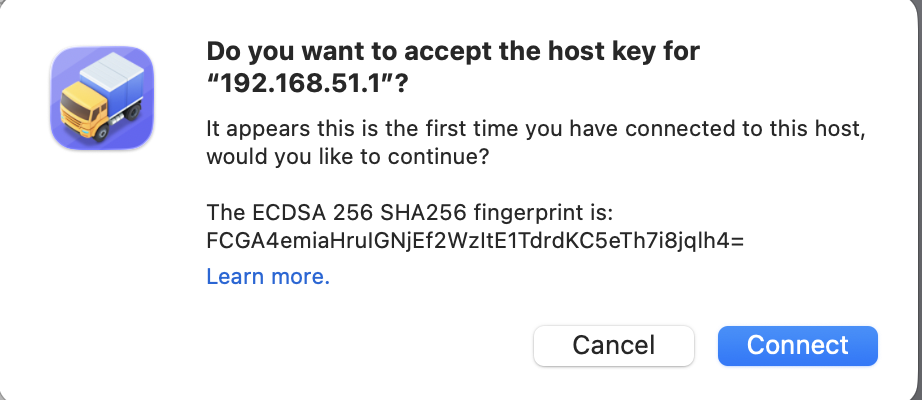

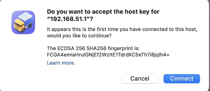

I suspect this is your issue. SSH keeps fingerprints for each known host in ~/.ssh/known_hosts. The fingerprint from the new dwarf will not match the fingerprint from your old dwarf. You can remove an entry using the command outlined here.
removed the host, and got this, very promising:
but sadly it did not work:
I must be honest, I have no experience with that software. But, considering that you can access the WebGUI on the same machine, I would say that something is wrong on the software side.
