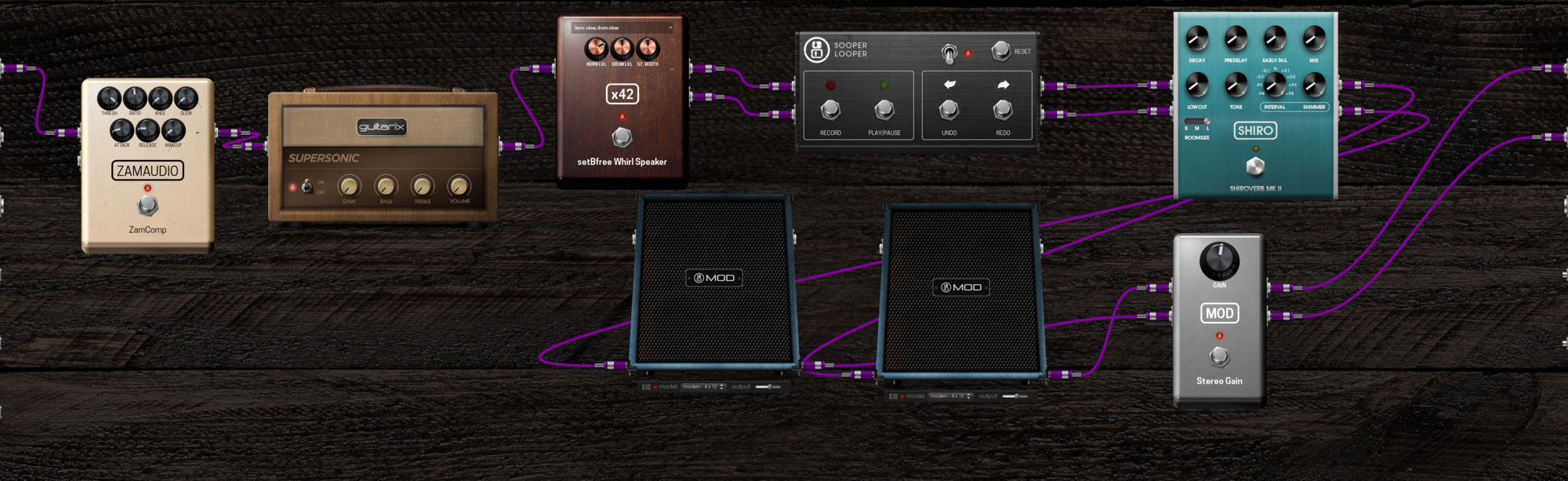

Then I’ll do some more testing tomorrow. Can you maybe share a pedalboard in this thread in which you use the SooperLooper and have encountered this problem?
yes I can share it. For testing I’ve done a very simple pedalboard. But I have the same issue on all pedalboad. Would you like me to share my big “all in one” pedalboard?

Hi @Steven_VE
I’ve share a simple pedalboard so you can try it to find the issue.
I use it with a Mod footswitch, but with or whithout the footwitch there’s same issue.
If I delete Sooperlooper and load it again in the same pedalboard it works.

I can’t seem to produce any bugs using this pedalboard. I can use the SooperLooper right away after I load the pedalboard. So I have some question for you:
Can you explain a bit more about what exactly is not working?
How often does this bug happen? Every time or only sometimes?
It happens every time. I have assigned looper to CC footswitch, after turning on my mod the buttons on CC Footswitch are empty, I need to change pedalboard and get back, after that CC Footswitch has assigned buttons.

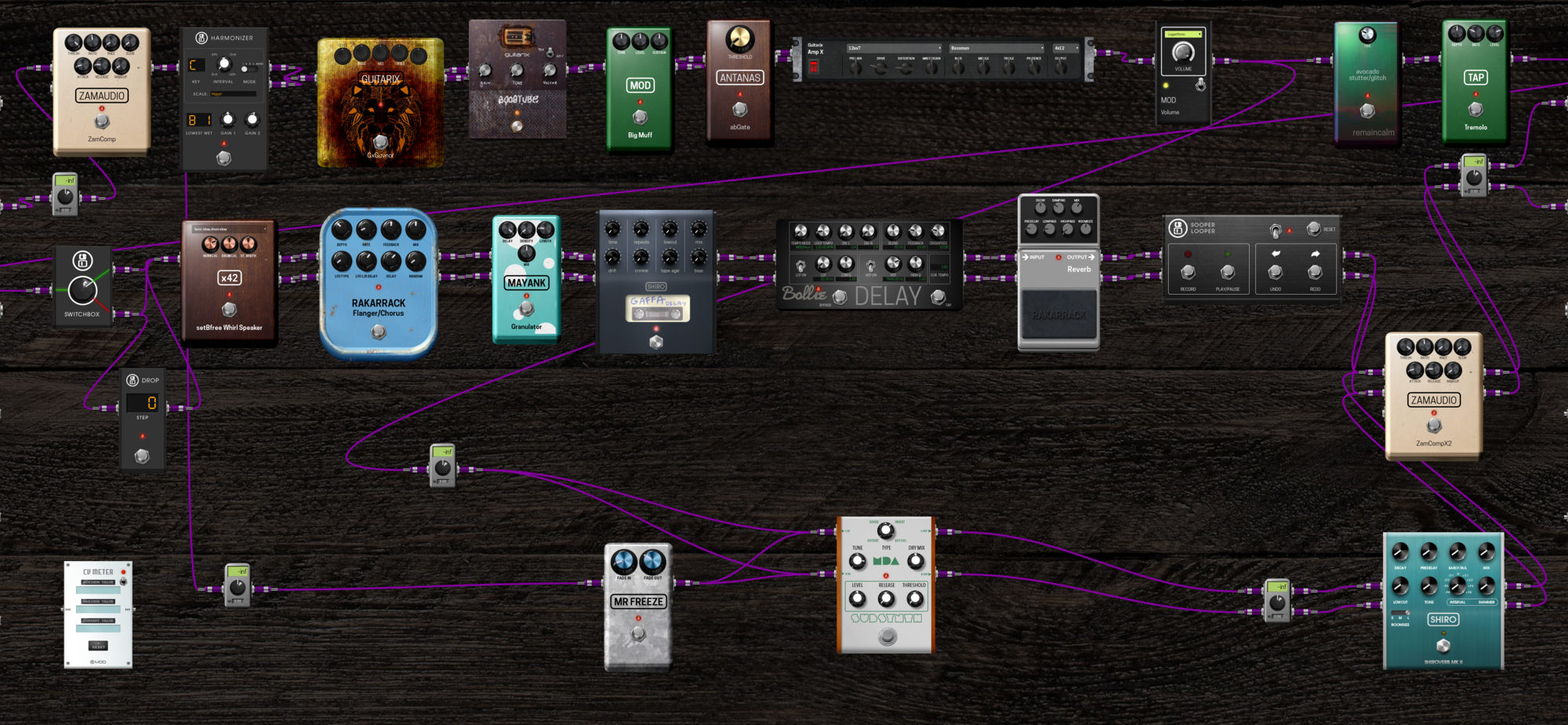

Hi.
I don’t use this simple pedal board every day. I just made it for testing sooplooper issue.
I’ll share the “all in one” pedal board I use and that have issue with sooperlooper.
I just tried again and the sooperlooper doesn’t work.
I load an other pedalboard sooperlooper works.
So I think this pedalbord have a issue.
I use 3 Mod Footwitch, perhaps it’s part of the issue, I don’t know…
I can see some beta plugins on this pedalboard. If you remove them do you still have the issue?
Ok. I’ll try that.
