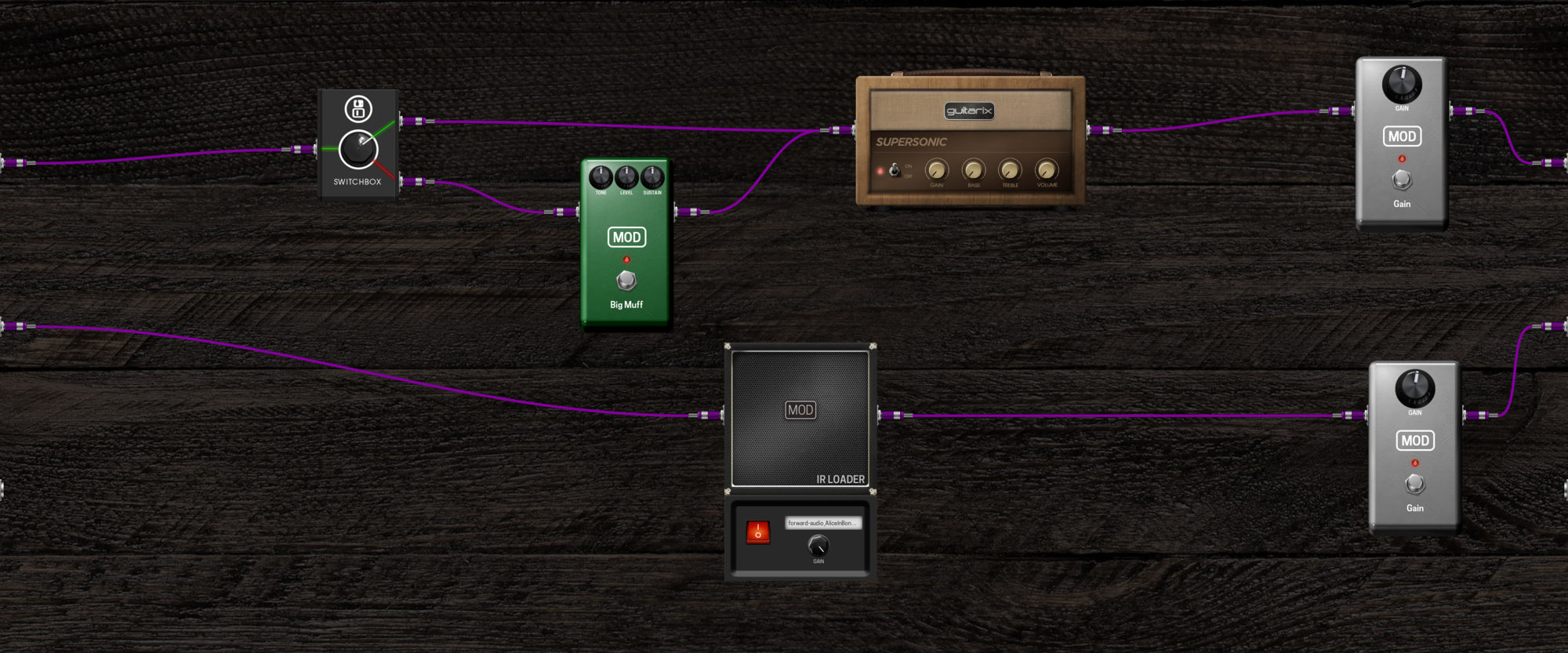

I followed your posted steps and I see the correct behavior (the knobs both change the channel on the 1-to-2 switch) Here’s the pedalboard I used:
This is weird.
I just tried your example pedalboard and it is not working on my DWARF… maybe a firmware/software version issue?
