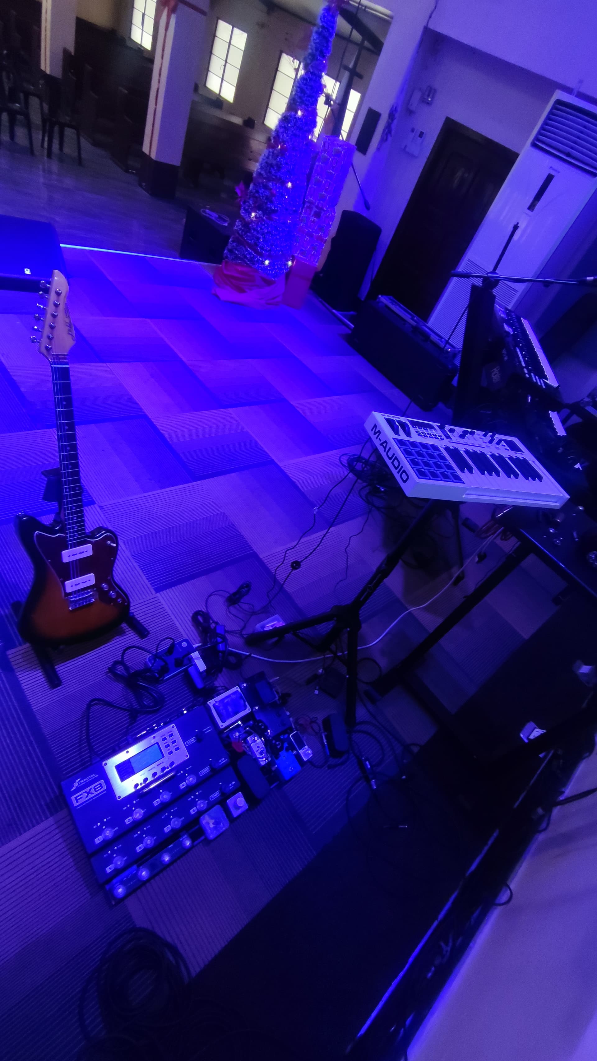

I’ve been using the mod dwarf with Tonex one and Fractal Fx8
My problems are:
  1. Changing Snapshot sometimes overloads the system and crashes/restarts the unit
  2. Changing snapshots MUTES the output and hangs up during live
  3. Multiple generator plugins (used w/ Midi keyboard) hangs up and sustains through even if not used. ex. Fluid ensemble plugin
The unit is barely usable if you have a lot of plugins in one pedalboard. Locks up, hang, crashes
Anybody got any advise on what to do?
