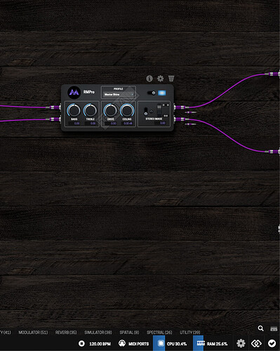

so whats the single usage of cpu on the dwarf?
For me, the consumption of RMpro on my dwarf is 30.4% cpu.

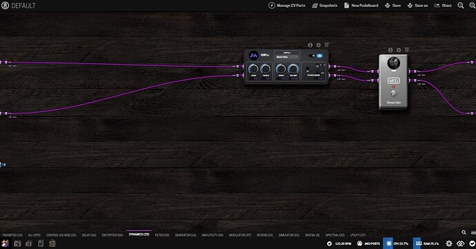

I agree, it is CPU intensive. But…I checked it intensly and I love it! It is really one of the finest plugins!
Especially for my Mandoline the sound in absolutely enhanced, pointed, cristal clear and deep. This is really an enhancement!
I checked some simple boards and made it more and more complicated. By the way: I used the Dwarf!
Only RMPro: 32.7%

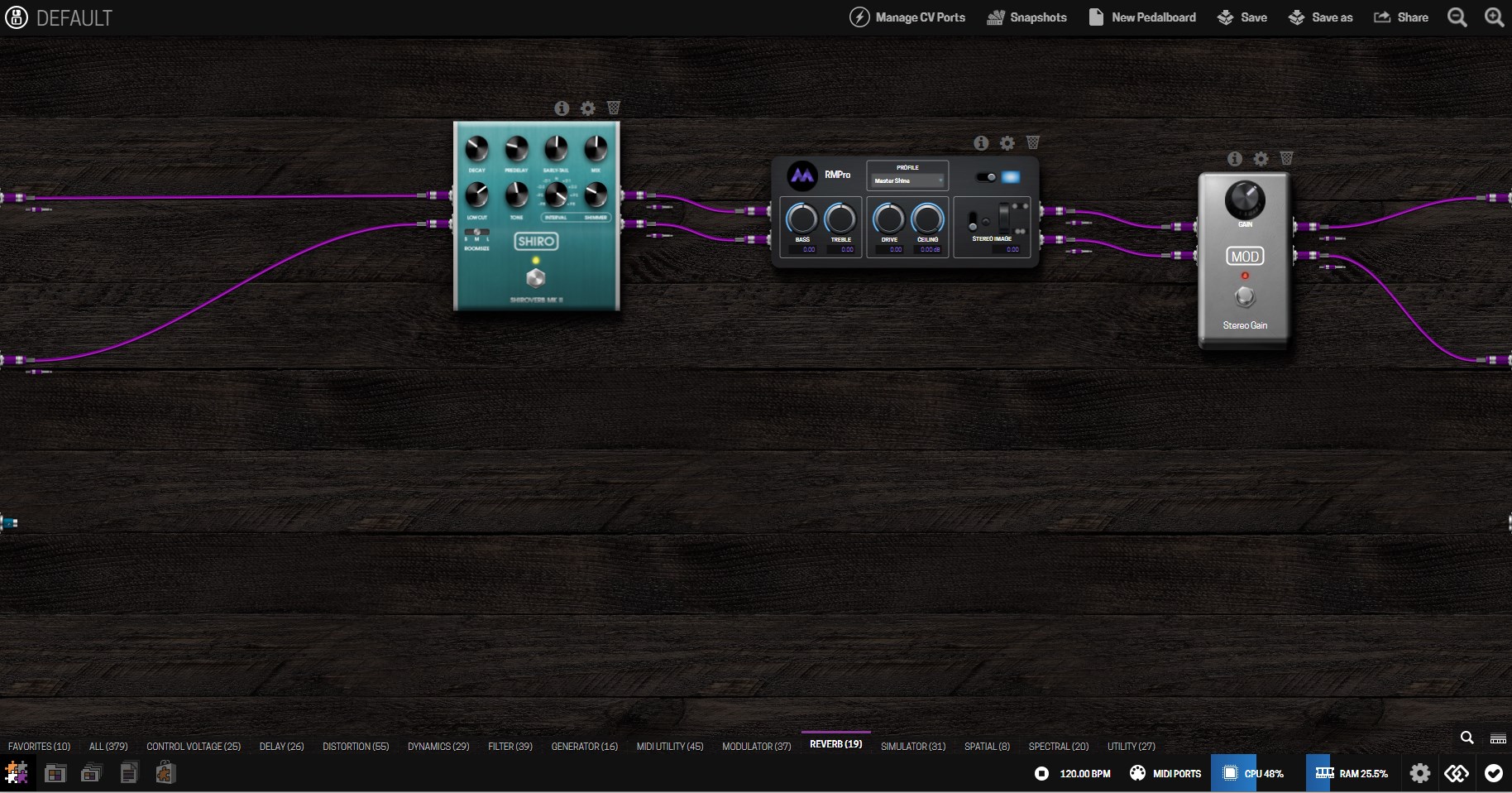

RMPro with Shiro MK2 reverb: 48%

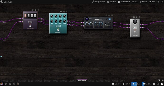

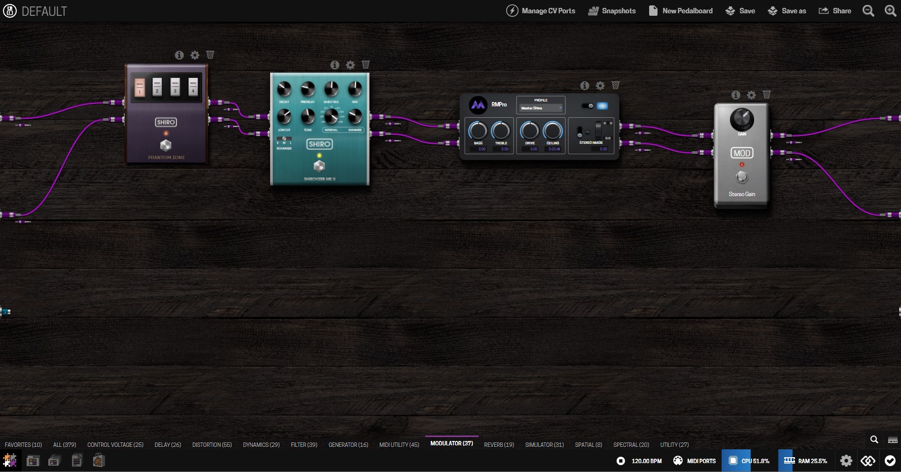

RMPro with Shiro MK2 reverb and sophisticated modulation: 51.8%

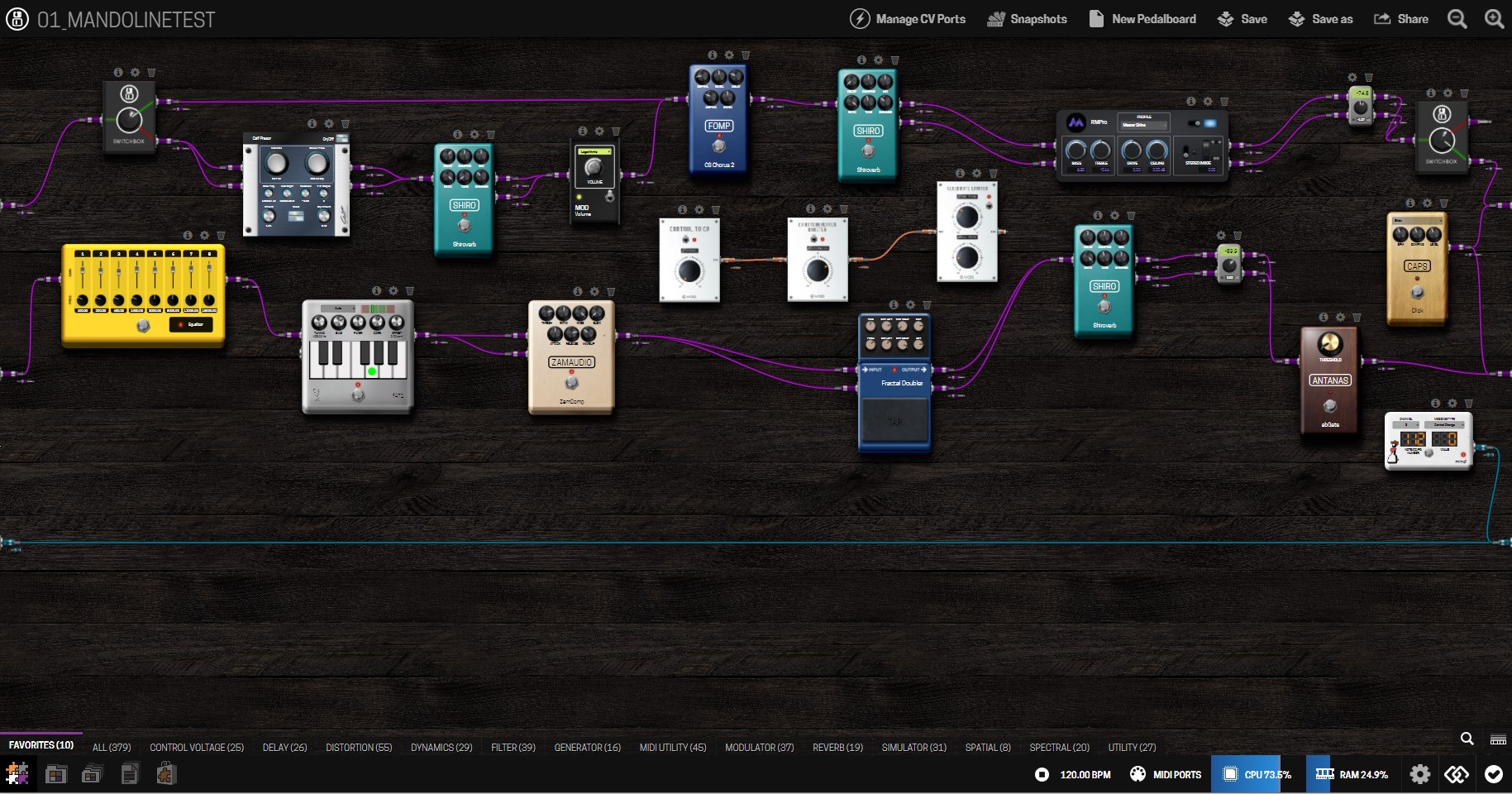

And last not least a complex board, the uper line is for Mandoline, the downer line for singing. Lots of plugins and Midi related stuff: 73.5% to about 82%
Especially stacked reverb is a problem with RMPro. The CPU consumption increases rapidly if you take more than one reverb.
For really complex boards RMPro is too heavy. On the flipside you can take out lots of plugins of you board after pluging the RMPro (e.g. compressor, EQ etc.). In about 60% of my pedalboards it works. With one word: It is a cool plugin and I love it!
