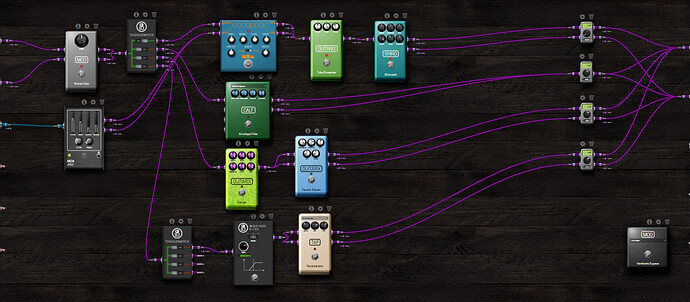

I’ve found a new annoying bug, while I was creating a new patch for live-set. The pedalboard looks like this.
All snapshots assigned to the Endless Knob, after some time interface of ModDuoX not responding or starting to be really laggy. Like I have huge latency between knob rotation and response to it. Web GUI still accessible. Reboot solving this.

what browser are you using?
does it keep happening if you leave the web UI open for 30m-1h?
If so, I have an idea of what the issue is…
I’ve tried with and without USB>PC connection. Result is the same. But I’m using Opera. And I don’t know about timing. I played around with the patch more than 30min for 100%
