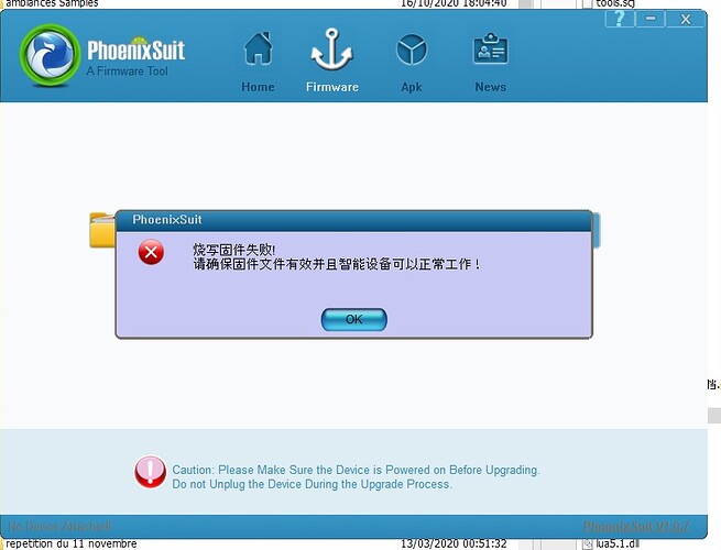

I still experiment issue when upgrading. Unfortunatly I didn’t had enough time to try youe proposed solutions. Now I try to upgrade to 1.10.0.2141.
1 It doesn’t work with the web browser . The mod duo display “starting upgrade …” for about 15 minutes. Nothing happens
2 Same with manual upgrade, from systme menu of the browser and menu of the Mod duo
3 So I try the method " Troubleshooting Reinstall via LiveSuit". everything works fine until I get the window “Upgrade…”. After clicking Phoenix suite crashes. I deplug and replug the Mod duo, I get the window “Tips: does mandatory format…” I click Yes and I get this message
So what can I do? And what doesn’t run?

Thanks for answer. Yes my mod duo works fine and I normally access the web GUI. The problem happens when I try to make an update.
1 from the web GUI: the update download and the mod duo freezes on the message (something like) “…is now updating please wait”.
2 same thing when trying a manual update.
3 So, after reading several wikis I though it could be a good idea to reinstall the system via Live Suite. I think I followed precisely the instructions before getting the message I sent in my last post.
This issue is not really annoying as far as I can use my mod duo , but it just worry me as far as no system update seems possible.
So you tried the LiveSuit option but the unit is still booting after that has failed?
Might be you have a Duo with MMC, while LiveSuit is only suitable for reinstalling for NAND units.
Details at Troubleshooting Reinstall Duo - MOD Wiki
Do the device screens still work correctly?
Yes everything is working correctly: The Duo boots up and the screens display are Ok. You’re right, after further search I think I have a MMC. It was not very clear for me that reinstalling with live Suite was only for NAND.

I try your mehod. the duo freezes (waiting for about 15 minutes) on splash creen with MOD DUO on the right screen and the logo on the leftt screen.
hmm alright so that explains why the update is failing.
not sure how it got into this state… some previous install attempt aborted at the beginning?
in any case, we can just reinstall, just wondering the best way now…
do you have a linux or macos machine around? a VM would work too.
Yes I Have a linux PC (Ubuntu). May be possible to share a mac
