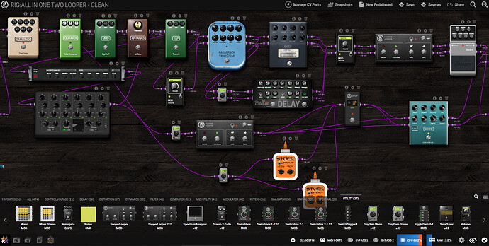

Hi Filipe!
I’ve tested the RC with my Mod Duo that night.
It’s very promising.
I haven’t try the new file manager yet.
I’ve many bug with control chain:
  • Control chain footswitch FootEx2 still deconnect when I press many time on switches, making the control chain footwitches unusable.
    But the good news is that I don’t need to reboot the Mod Duo now. I just have to unplug and plug the footwitch and reload the pedalboard.
  • An other weird thing is that the first control chain device on the chain is sometimes recognized as the footEx2 and sometimes as FootEx. :crazy_face:
  • The control chain footwitches doesn’t work with pedal effect that are bypassed until I press 4 times on a switch. I have to do that for all assigned pedal effects. If I load a other snapshot and the state of the pedal change on or off, the footwitch doesn’t work again.
  • The Rakkarack Chorus/Flanger doesn’t work with control chain footwitches. there are to many bug. I suspect it to make the Mod Duo freeze when changing snapshot from the Mod duo footswiches. Since I have removed it from the control chain I have no more freezing.
  • I always have the same snapshot name on the Mod Duo screens when assigning snapshoot change to Mod Duo foowitches 1 and 2. I understand snapshot names after and before selected one where shown on left and right screen now. Did I misunderstood?
  • Sometimes the Mod Duo rotary control become very laggy, reacting 1 action later. For ex: If I press the encoder nothing happend and then if I turn the rotary it acts like if I’ve pressed it. That make it pretty unusuable. But it doesn’t happen very often.
The good things are that new control chain functionalities work perfectly:
  • global tap tempo is cool
  • preset change is fun. But preset name on the control chain footswitch doesn’t follow presets selected in the editor.
So my setup with two control chain device is still unstable. I can only use one control chain device for the moment.
I’ll test stability with only one control chain device later.
I hope my little contribution is understandable, my english is not quite good.!
Here’s my actual pedalboard.
