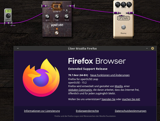

First time I see this… what browser (and version) are you using?
does it look the same on other ones?
#metoo
I use Firefox on OpenSuse; always have. Clearing the cache did not help, but Chromium shows everything correctly.

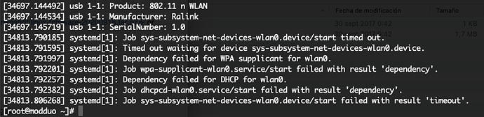

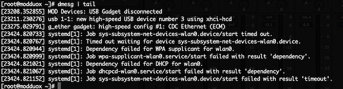

I’ve tried with a Ralink (which doesn’t seem to need dkms) and with the Realtek and both send the same messages:
dmesg doesn’t say anything about the concrete driver required, only “dependency”. Anyway, in 1.10 can be two Duos (or one Duo and one DuoX) connected to the same computer via USB? That’s why I’m worrying about the Wifi thing, because they both are part of my studio and connected to the Mac…
that is odd… can you try the WiFi steps on the duo, rather than the duox?
at the moment you cannot have 2 units connected via usb, only one of them will work.
the typical workaround is to use bluetooth for one, usb for the other.
But again, I recommend to try the WiFi stuff on the Duo. It has a newer kernel compared to Duo X, so it will support a couple more drivers.
This is the DUO with the Ralink (with the Realtek it’s more or less the same msg):
It’s not mentioning anything among the driver… This concrete USB wifi stick has the chipset recommended by the Organelle guys and lots of people which do projects with Raspberrys and these kind of Linux devices (I say this becase the Realtek USB is for Win/Mac and maybe it’s not so “linux friendly” as the Ralink).

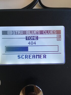

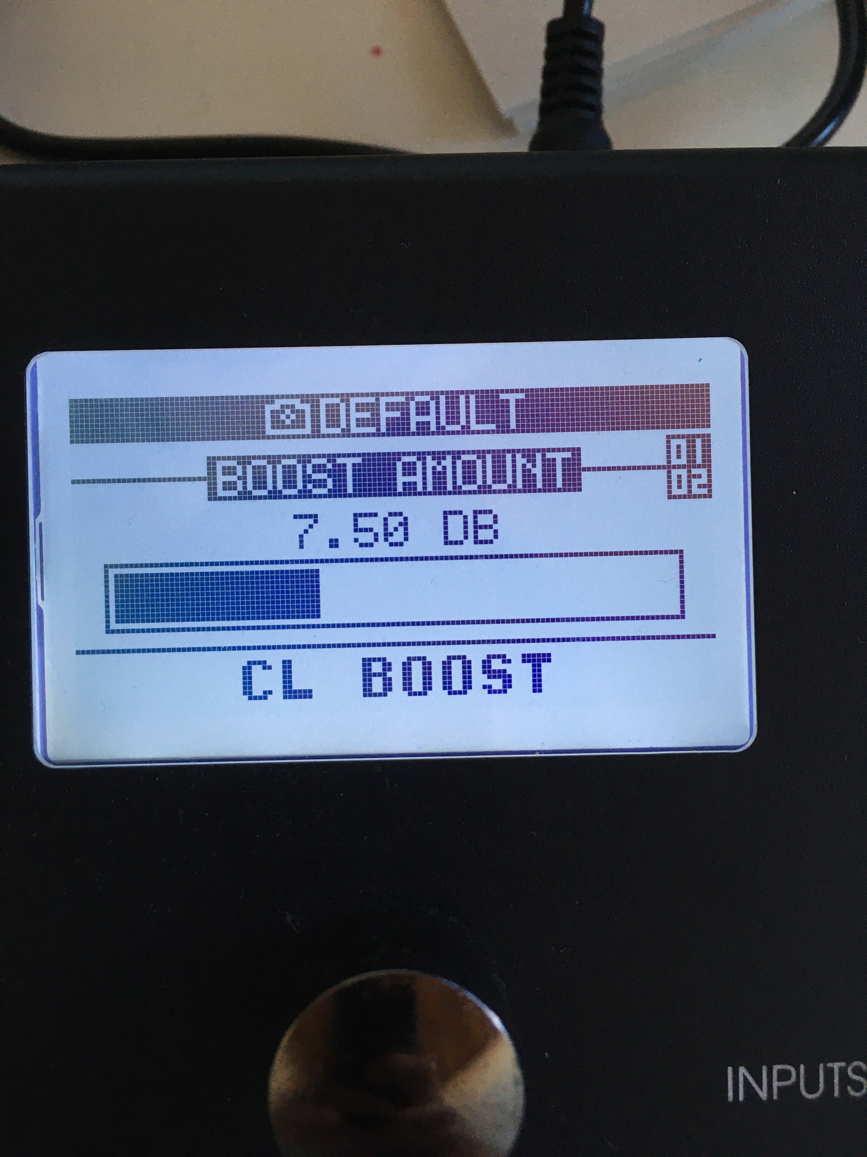

I took a couple of pictures of both screens with a random pedalboard (let me know if you want to see more)
Here are they…

Thank you very much for answering. The new interface is indeed much more informative and usable than the former.
The only doubt I have, and I can’t check until I have the new software installed, is if it’s too difficult to read the new smaller parametar values when standing on stage with the Duo at my feet.
I know that there’s the “value bar” that gives you a quick gauge of the parameter, but in some cases you want to read the precise numerical value, say, for delay repeat or tempo.
