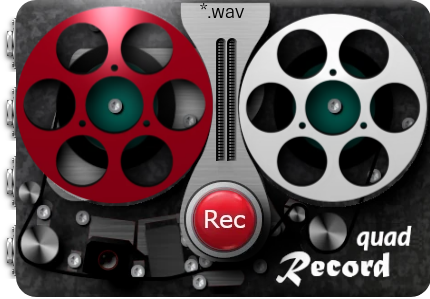

Hence I made some new recorders for you. First one, a quad recorder. It is capable to record a 4 Channel file. Currently, you can’t playback those on the MOD, but that may change after some time. Anyway, you could download them from the MOD and open it with the DAW of your choice. I hope 4 channels been enough to capture your sessions, otherwise, it wont be to hard to make one with … channels. ![]()
And then, on request, I’ve made “mini” versions for all recorders:
Those been meant to catch less of the screen and less of you attention, so you could focus on the Pedals in your board which matters for your sound.
Enjoy your MOD(X/DUO/DWRAF)
