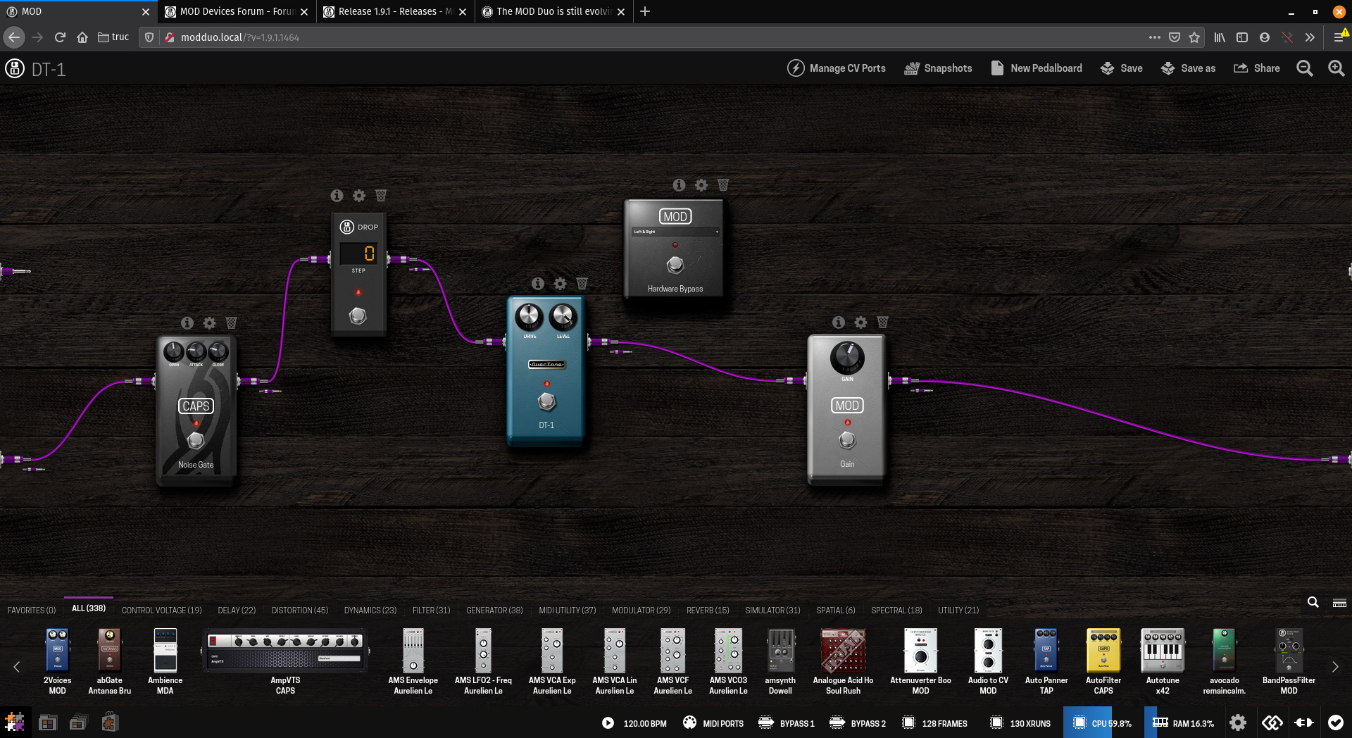

Since the last upgrade, purchased pedals (DT-1, Boobtube) are in demo mode (the sound cut itself then come back progressively), despite being tagged as “purchased” in the UI.
How to reproduce
  1. Take a NAND Mod Duo with purchased pedals (DT-1, Boobtube), makes some pedalboard with purchased pedals.

  5. Open a pedalboard with purchased pedals and test the sound.

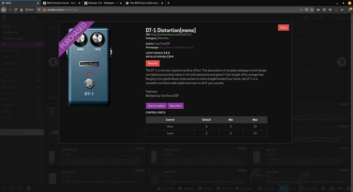

I tried to remove the affected pedal from the pedalboard and then replace it but it’s the same.

Can you try reinstalling the plugin?
It worked thx. xD
I’ll add my anecdata: I did not have any problems with purchased plugins after the upgrade, but I didn’t restore my plugins, only my pedalboards, so the plugins have all been installed on-demand.
I think I have the same issue with the DT-1 pedal.
It doesn’t give an update option though. There’s a remove button - do I need to do that and reinstall it?
The update all button says everything is updated, even though the DT-1 says installed version is 2.0-3 and latest is 2.0-6.
edit: Yes, remove and then install does fix it.
