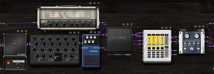

Describe your signal Path or post an image of the pedal board.
Yes thx, but this is the point where I think it’s not smart to use them for that purpose. Let me put an example dow, n there.
It’s just a start, basically 2 chains, 1 for humbucker, 1 for piezo with IR.
