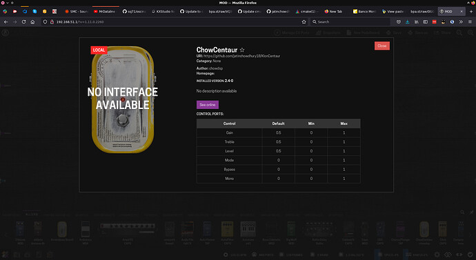

and for a little proof I guess..
Going to try the AnalogTapeModel plugin next.
EDIT: tapemodel fails to build in xsimd::batch<double, 2>::batch()
Amazing @falkTX!! How does it sound on Mod? Now we can start to look at NeuralPi too potentially :grin: that would be one of the coolest plugins for guitarists!
I never used the desktop version, so cant compare. Sounds like a distortion to me :sweat_smile:
CPU usage was okay, you can kinda see it in the screenshot too, I have the plugin loaded and around 21% cpu load.
It is not the lightest of plugins, but it does work.

mod-plugin-builder has been updated with modduo-static and modduox-static targets, and chow-centaur tested to build and run on both the duo and duox.
Only issue is xrun when changing mono mode, and perhaps parameters taking a little bit to apply (seems issues with the engine)
If left untouched, there are no xruns and dsp load is mostly consistent
Takes 20-25% cpu on the duo, which is not great, but not horrible either
