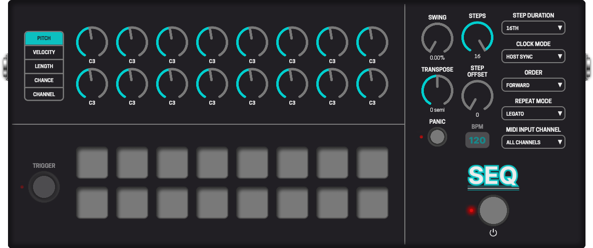

New plugin: dm-Seq
This is a mono midi sequencer. The available features for this sequencer are:
  • Pitch and Velocity patterns can be configured with the knobs in the top left panel of the UI. The Gate buttons in the bottom left section are used to set which steps are activated.
  • Clock Mode supports a Trigger mode! Press the Trigger button to proceed to the next step. Host Sync and Free Running modes are also supported. Like in the Step Seq x42 plugins Free Running follows the BPM parameter of the plugin.
  • The Order parameter changes the order of the steps. Forward, Reverse, Random and Shuffle are the different modes available. Shuffle is like random but without repeats.
  • You can dynamically set the number of steps of the sequence. So with two instances of this sequencer you could create polyrhythmic patterns.
  • Repeat Mode supports a Legato and Retrigger mode. Legato ties notes together when a note is repeated. Retrigger will send a note off followed by a new note on
  • Step duration can be set to whole notes to 64th notes.
  • Swing adds swing of course
A first version of the plugin is available on this cloud builder page.
A Mod Desktop version can also be downloaded from the github release page.
By default all steps are deactivated, so don’t forget to activate them by punching the Gate buttons to get some sound.
That’s it. Enjoy and let me know what you think!
-Dave

I’ve tested the plugin on my mod dwarf. The trigger button allowed to move between the gate. It is very nice ! Is it possible to have the number of the Gate on the Mod dwarf and another Trigger to open or close the actual gate ?
That’s very promising ! Thanks for your work
@Remy_D I need some more specific info about your feature requests. Do you mean you’d like to see the step number on the Dwarf device display? And could you clarify what you mean by a Trigger to open or close the actual gate. Because all separate gate buttons are assignable
Thank you all for the quick feedback by the way!
You re right.
You press the trigger to choose the gate. The number of the gate appears on the mod dwarf.
Then You press another switch to open or close the gate You re on.
Is it ok for You ?

Here’s an updated version for your MOD device.
The MOD Desktop version can be downloaded from my github release page again.
What changed is:
  • Added MIDI Panic button
  • Added Channel sequence
  • Added Note Length sequence (disabled when in Trigger clock mode)
  • Added Step Offset param. The sequence will start from this step. In Reverse order mode it will be step minus Step Offset.
  • Added Alternate, Pendulum, Shuffle B, Brownian, Either Way order modes. Shuffle B avoids possible repeats when it’s reshuffled. Unlike Shuffle A which can result in a repeating note when it’s reshuffled.
  • UI has disabled state depending on what clock mode is selected
I’d like to know if this Note Length parameter is useful to you. I decided on multiplying the step length from 0 to 2. Any other ideas about that? With this feature you could get overlapping notes which means this is no longer a strict monophonic sequencer as advertised. :smile:
