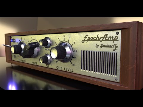

Thought I’d share here for anyone interested, I have a new plugin out called EpochAmp, here’s a video, and you can download it for free from GuitarML.com. I had almost as much fun making the video as I did making the plugin. Enjoy!
I just fired it up in Ableton out of curiosity and… it’s pretty good. Granted I didn’t do extensive testing or ABing, I just strummed a few chords, realized that mode two effortlessly gives me that ‘edge of breakup’ thing that I like, slapped an Ownhamer IR on it and was like “sure, I could record with this”.
Few points of feedback:
A mix knob - while potentially useful in general music production - is less useful from a strict guitar playing perspective (unless maybe someone wanted to run an acoustic trough it, but there are other ways to mix a plugin into your signal inside a DAW). A basic tone knob (even if that would have to be a post-amp eq given that this is a captured/profiled/emulated amp) would be infinitely more useful. My main guitar was a touch too dark with this amp, and I quickly remedied that with another plugin but a tone knob would be ideal.
Some basic documentation/description of what each mode resembles/emulates would be helpful. I’m sure there’s a philosophical discussion here about expectations affecting the way we perceive tone, but I think most guitar players find basic generalizations (“American black panel amp”, “plexi”, “vox-style” w/e) useful. That second mode sounded kinda-sorta like a Marshall or maybe non top boosted Vox. but I don’t really know.
CPU usage is not outrageous by any means, but it’s in the neighbourhood of something like Helix Native/Amplitube/Guitar Rig, which for a single amp is on a higher said. Though I guess amps based on machine learning are inherently more resource heavy than modelling (just guessing based on experience with other plugins).
This is just a preference so you can completely disregard it but I don’t care for skeuomorphic look.
In general, great stuff. This is the kind of Amp Dwarf needed more of - easy to use but great sounding.
