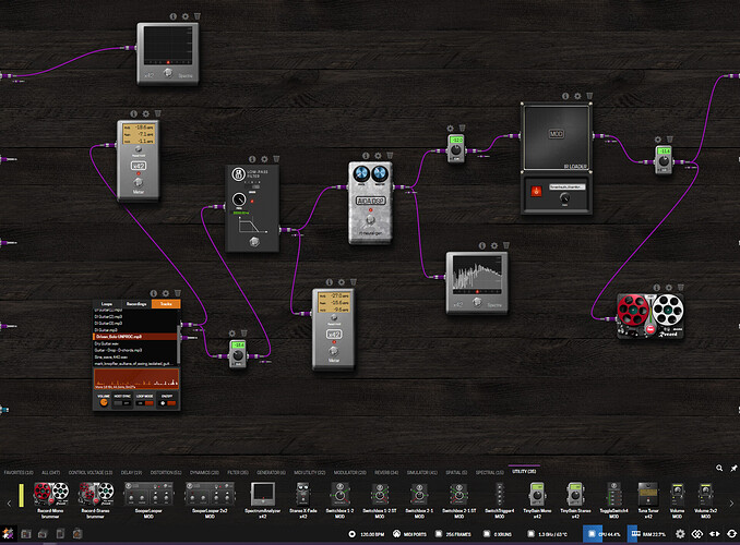

Less noisy but still noisy.
Noise is there even if input side is not connected (red circle)

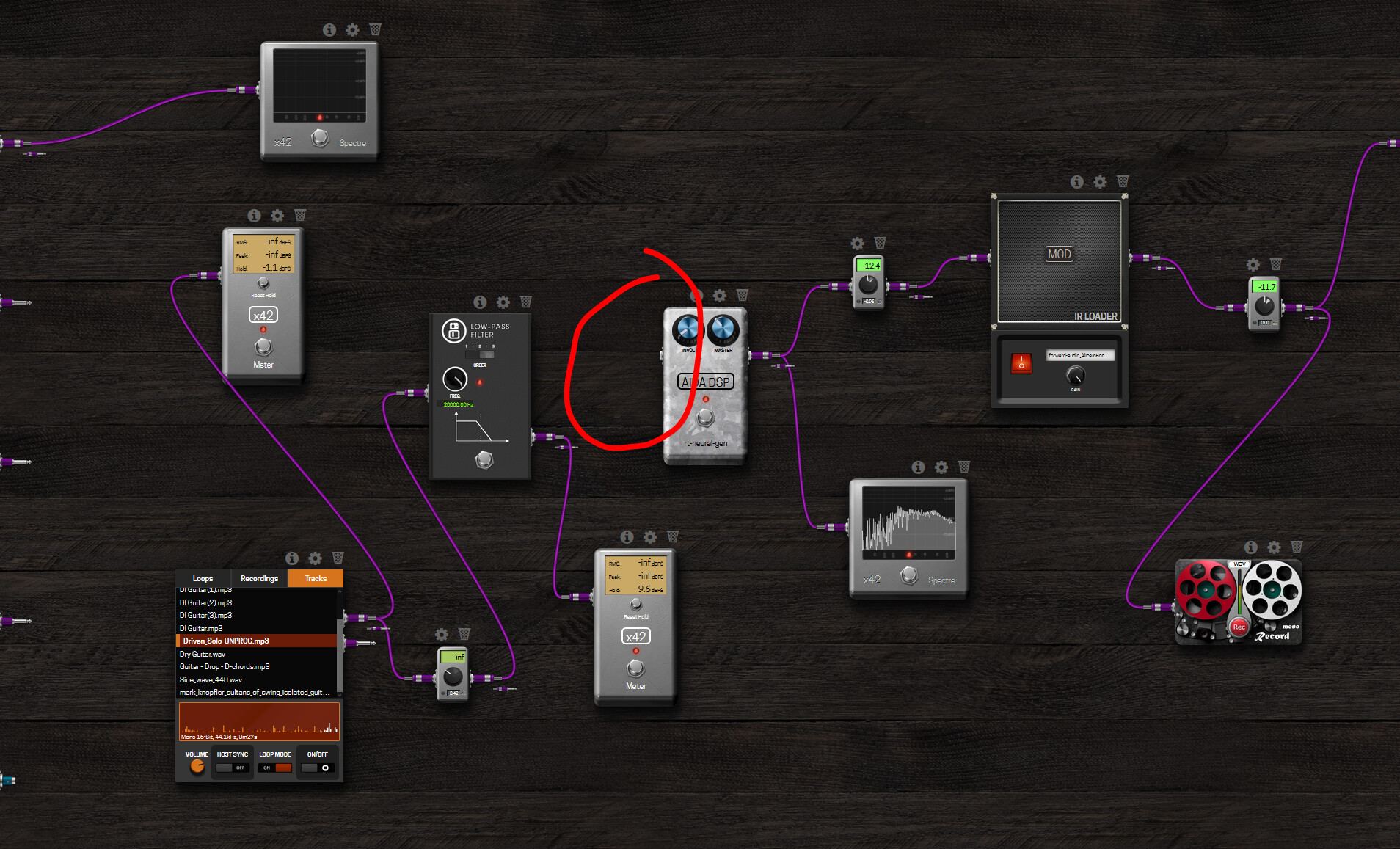

MoonJazz.json Vocaroo | Online voice recorder
Okay, that’s because now
define AIDADSP_LV2_INSTALL_TARGET_CMDS
is running instead of the cmake install command. We need an APPEND, I know how to do that in yocto but not in buildroot any clue?
Try looking at other plugins’ mk on mod github.
Okay, I remember now I fall into the very same issue while playing with gcc optimizations. To build the plugin I use GNU 9.3.0. I see you have GNU 7.5.0. Can you do a test? Tweak the mk file by hand and remove -DRTNEURAL_ENABLE_AARCH64=ON. This should makes the plugin to consume more cpu, but the noise should go away (if I am correct)

Removing the -DRTNEURAL_ENABLE_AARCH64=ON works and the cpu usage it’s not increased that much. I’m going to test all the models. Later I will try to record some models from Cube Baby and Nux MG-30.

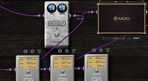

made a short clip of the problem - nothing is clipping.
Which preset / model are you using? What is the peak input level of the signal reaching the plugin? Thx
Hardly, but we never know. Does this happen with any other plugin or if you connect the ins to the outs do you have anything resembling this? Did you change something in the settings while sshing? Maybe the best would be to do a factory reset, although at this point in time it may be a bit hard ![]()
